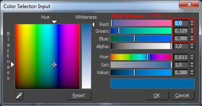

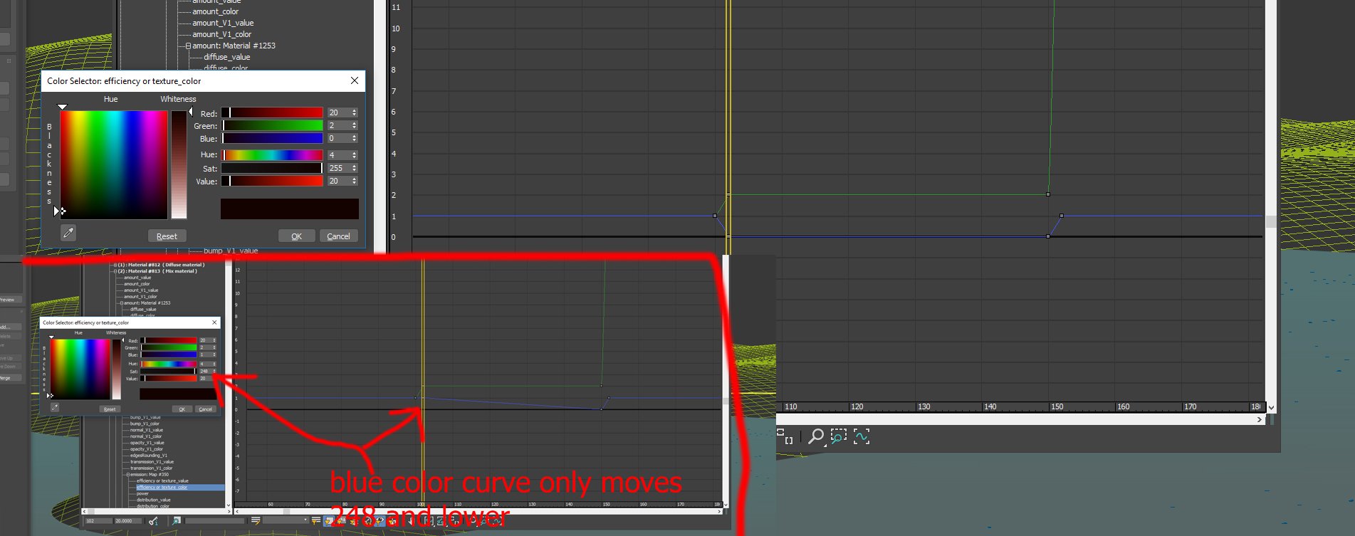

When we change saturation in color tab from 255 to 250 results dont get saved. If we change to like 255 to 240 they are saved. same apples with saturation near 1 and 255. values dont get saved. is it max bug? Video attached

Hi Coilbook,
This is just a result of numerical conversion done by max ..
The color is stored and used internally as RGB.. : if it doesn't change, it won't be saved ..
The Hue, Sat, Value version is just a temporary helper .. and for low RGB like your sample (20,2,0), several values of Sat gives the same RGB result..
So this is normal, and a result of the precision loss while converting with integer values of RGB ...

I got this reply on autodesk. Not sure if octane can do this one day
You got an reply in the thread you linked, that's not how it works - legacy shaders support 8-bit RGBA values, i.e. four integer values from 0 to 255, hence the limits. You shouldn't use them if you want higher precision for any reason, use for example Arnold shaders, Vray color or anything else that supports floating point values:
