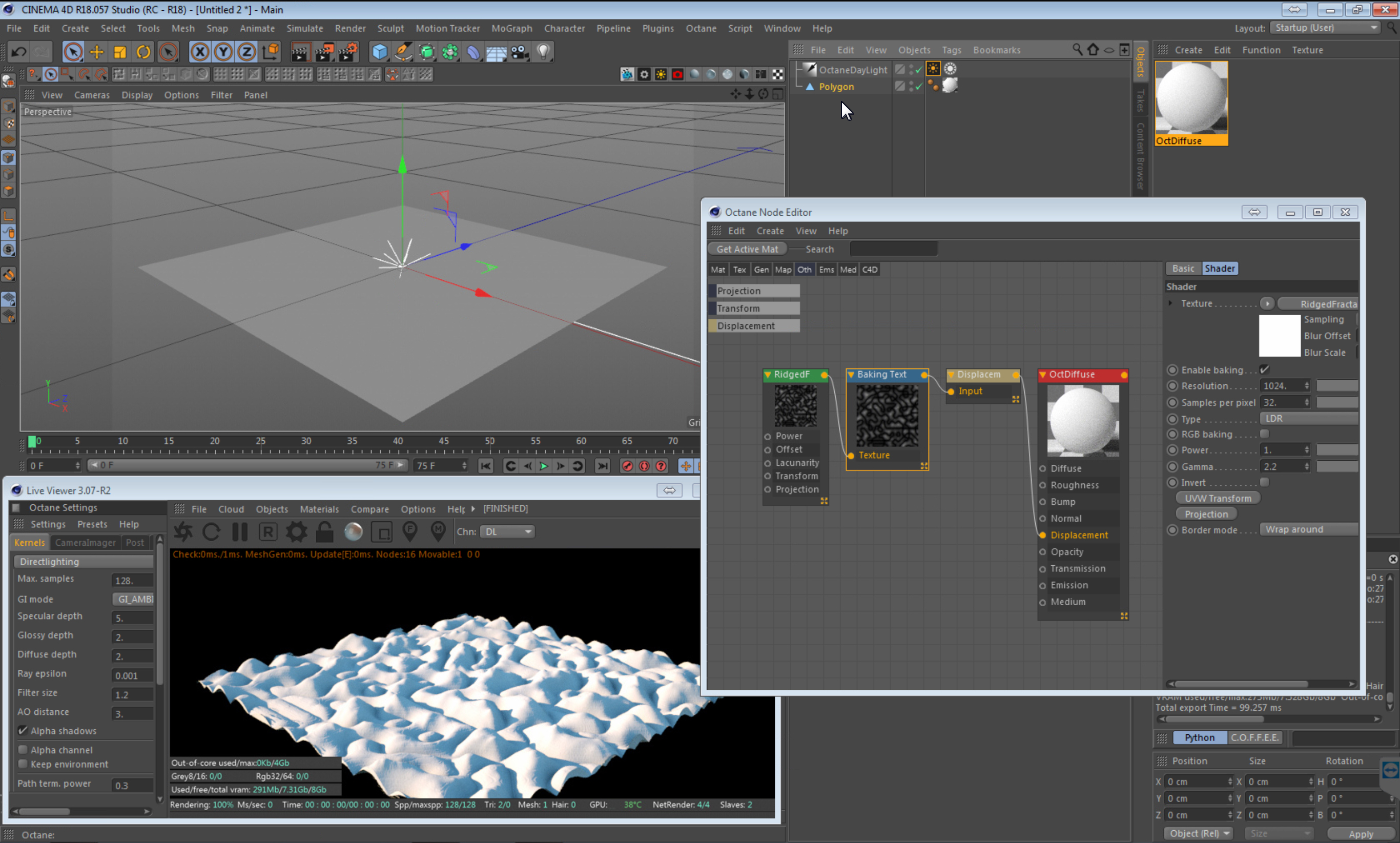

The easiest way to try the baking texture is with an Octane noise or shader and then in displacement: In practice, any group of node plugged into a Baking texture node are baked into a 2D texture node:
viewtopic.php?f=30&t=59827&start=30#p325189

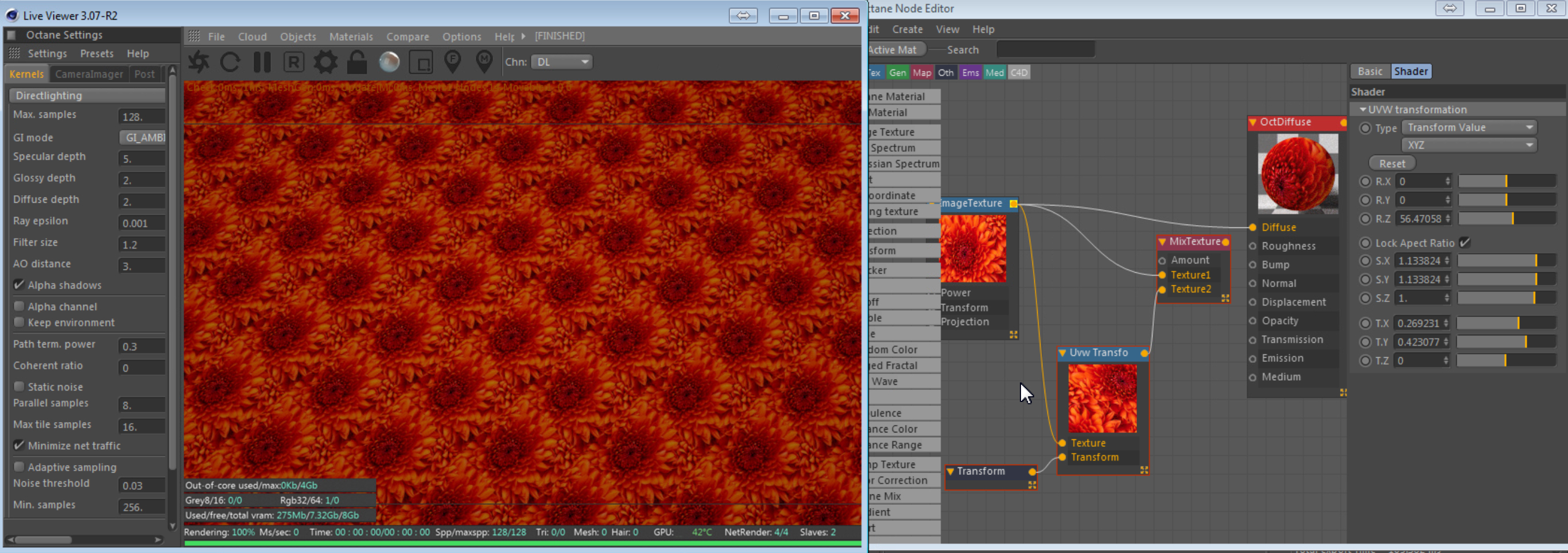

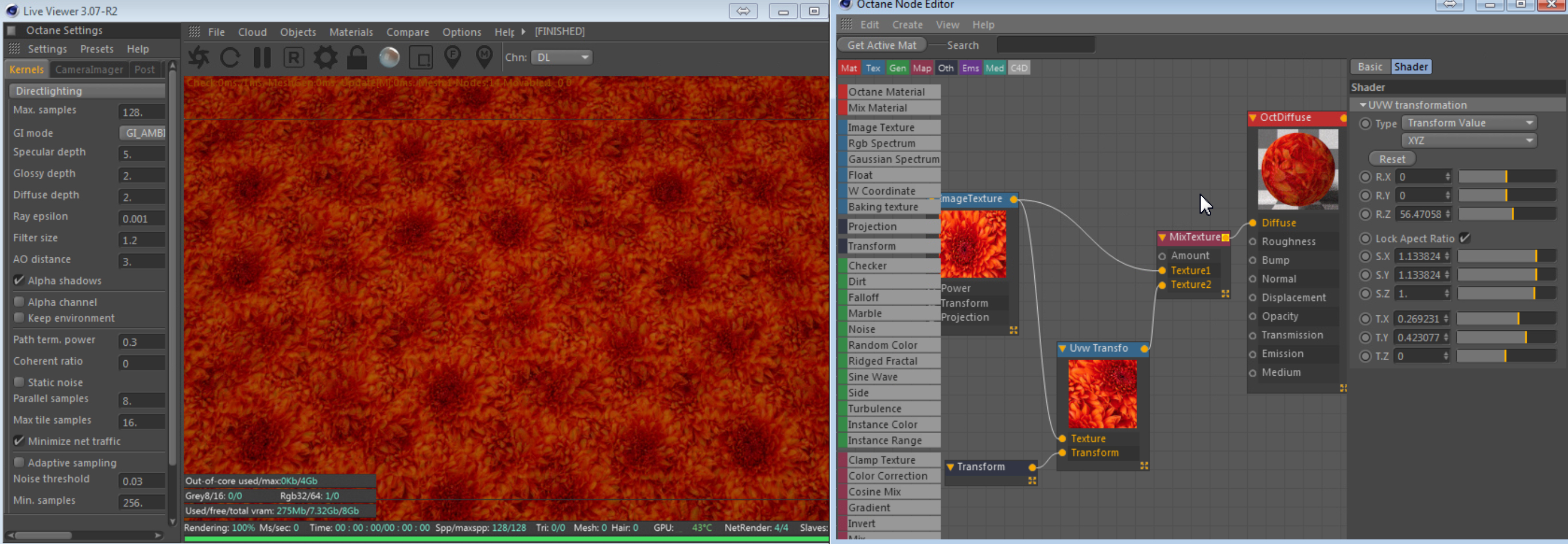

The uvw transform node is useful for mixing a different transformation other the same texture to remove the tiling effect: ciao beppe
