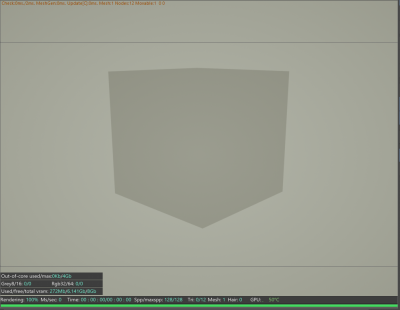

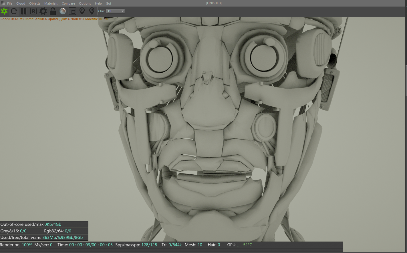

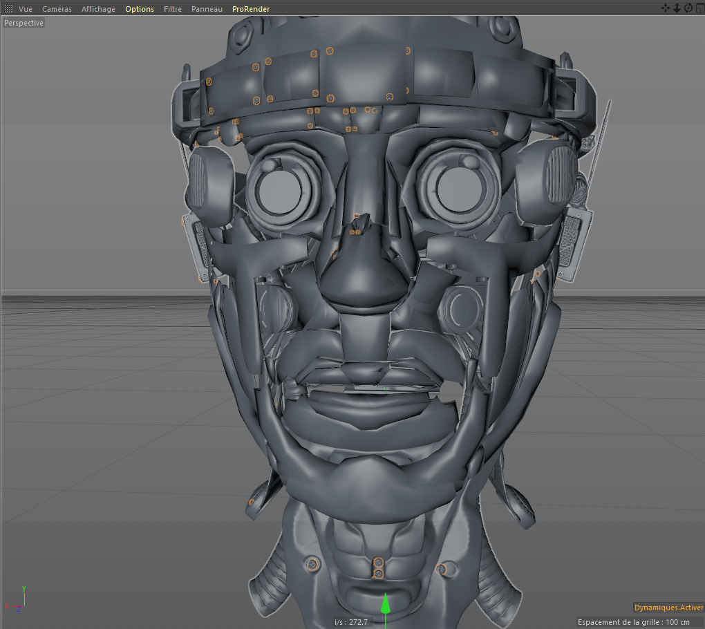

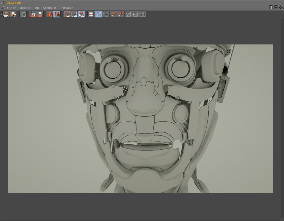

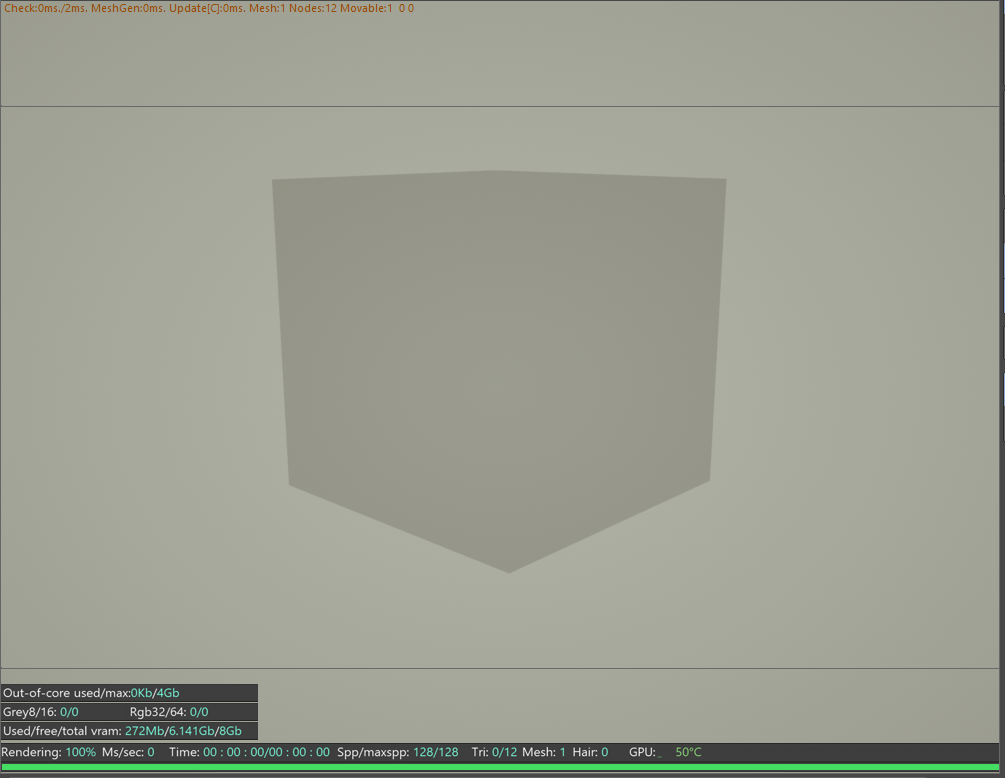

I would like to do so... But I certainly miss something, cause i set up an alembic file lowPoly and try to override it with an hiPoly file... But when I use the liveviewer it doesn't seems to work but finally when i use the picture viewer it's working ? How can i solve the render of my liveViewer ?

Finally it's not to possible to use the LV to see huge geometry, you have to make a render in PV. In summary the good method to work with alembic is :
1-create HiPoly and LowPoly . Export abc.
2-Import lowPoly and then override it for rendering
3-create the lighting and shading of your lowPoly object (not too low in order to have a render close enough of your final render)
4-And as usual, render in PV
Is that correct ?

LV will display the triangles what you see in viewport. Because it's using opengl geometry not final render stuff. Logic is simple i hope!
