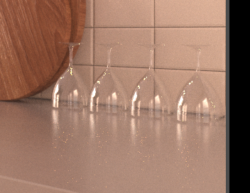

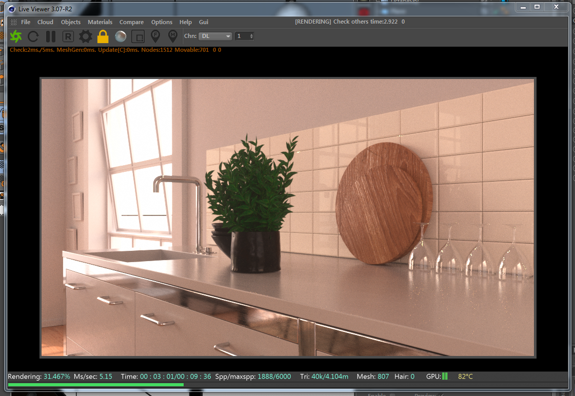

Hi everybody, I'd like some advices reguard this kinf of noise during live viewer render. :?:
I'll post some images about the probelm and render/camera settings
This is the live viewer
Zoom on the glasses
Point Live Viewer.PNG (201.51 KiB) Viewed 1393 times

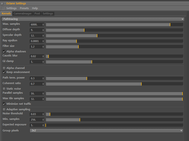

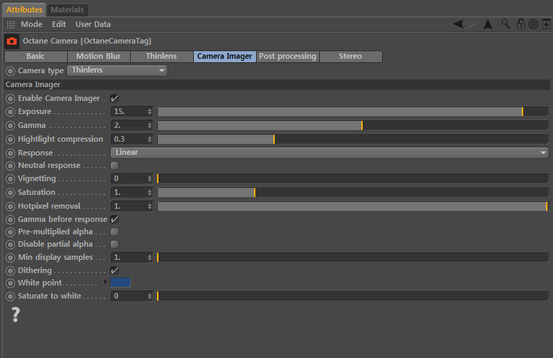

Octane Camera Settings
Kernels Settings
Can anyone help me with some advices?
Adaptive sampling how it's work?
Thanks to everybody.

hi,
Try to boost you'r caustic blur to 0.5, or just on the camera parameters unlock hot pixel removal.

What are you using for your lightsource?
I would definately switch on adaptive sampling and maybe check if your lightsource is set up correctly (e.g. importance sampling enabled), I don't think you should have hot pixels like these with with GI clamp set to 1.

RahiSan wrote:What are you using for your lightsource?
I'm using an HDRI for light source and Imp. Sampling is on.
