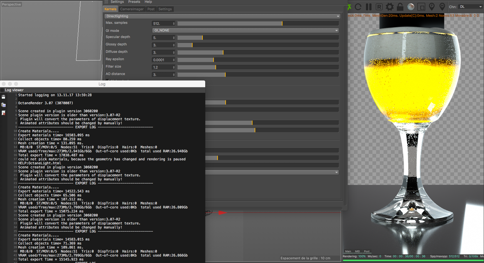

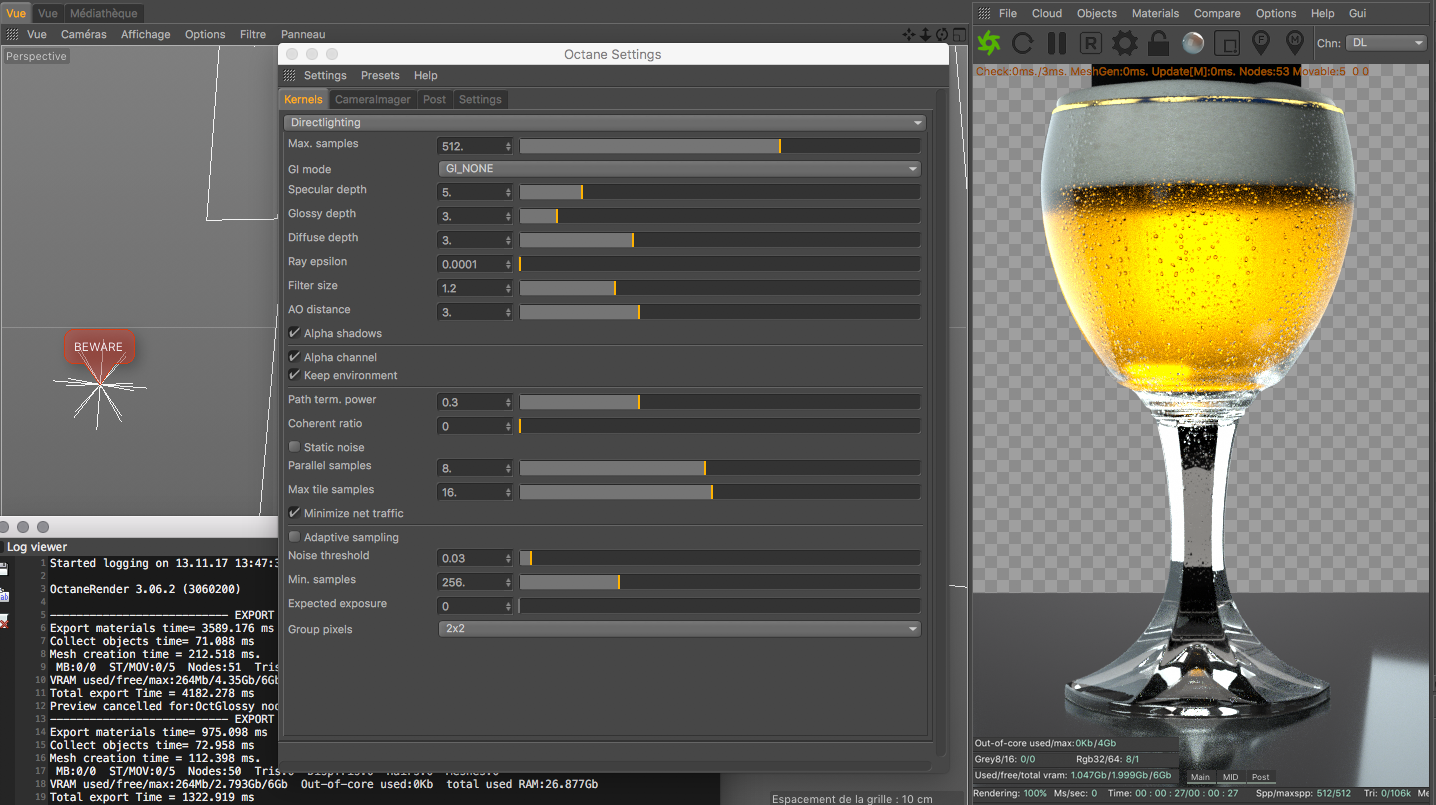

Hello.
I've just updated my C4DOctane plugin from 3.06.2 to 3.07 and the render result is quite different now… I'm working with R18.057 (OSX 10.12.6/Nvidia GTX980Ti/CUDA 9.0.197) & the result is the same with R19.024.
Any idea ?
Please help
after update
after update
before updante
before updante

I had same thing. Swithed back to render my old scenes.

Hi sguitton,
to answer at the numerous request, in 3.07, the emission node has been renewed with more settings and options:
viewtopic.php?f=24&t=62395
Unfortunately, in some circumstances the retro compatibility cannot be guaranted, and the emission needs to be manually corrected.
You need temporally stay with R18/3.06.2 with this specific scene, I guess.
ciao beppe

I suppose that you've rotated or changed rotX of the HDRI in your scene.
There was an issue with 3.07 plugin where you can not change this parameter, probably it could be your case, try to check it out.

Hi.
Nope, it's the exact same scene, no change between the two renders, just open & render with 2 plug-in versions :cry:
