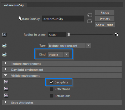

How can I set a bakground image using spherical proyection?
And it is possible have a hdr image loaded in the enviroment node but only as background and not lighting?

mrfactory wrote:Hi,
Hello, mrfactory,
I got corrected by Calus .. yes, you can try to connect the hdr texture in sky texture pin, check the "Backplate" in the visible environment.

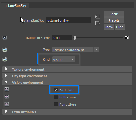

mrfactory wrote:Hi,
If you already have a sunsky node for lighting, you need to use a second "sunsky" node (created from hypershade) and set it as "visible" kind and as "backplate".
