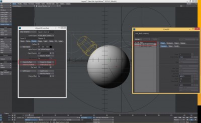

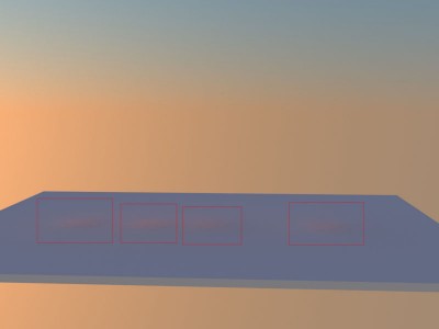

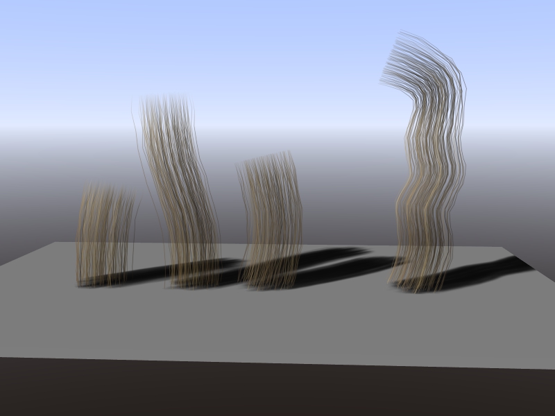

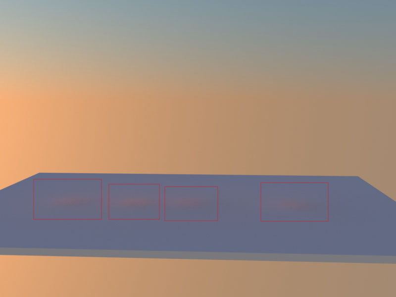

I was testting fiberfx, and I got some strange results. The Fiber are not showing in the ipr, and the F9 render. In the octane versions, something weird appears at the base of the fibers.

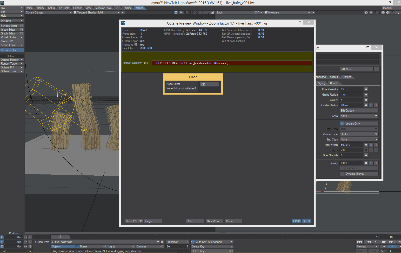

And I press F9 I get an error message (node editor not initialized). I am attaching the images, the scene file, octane log and the two renders.

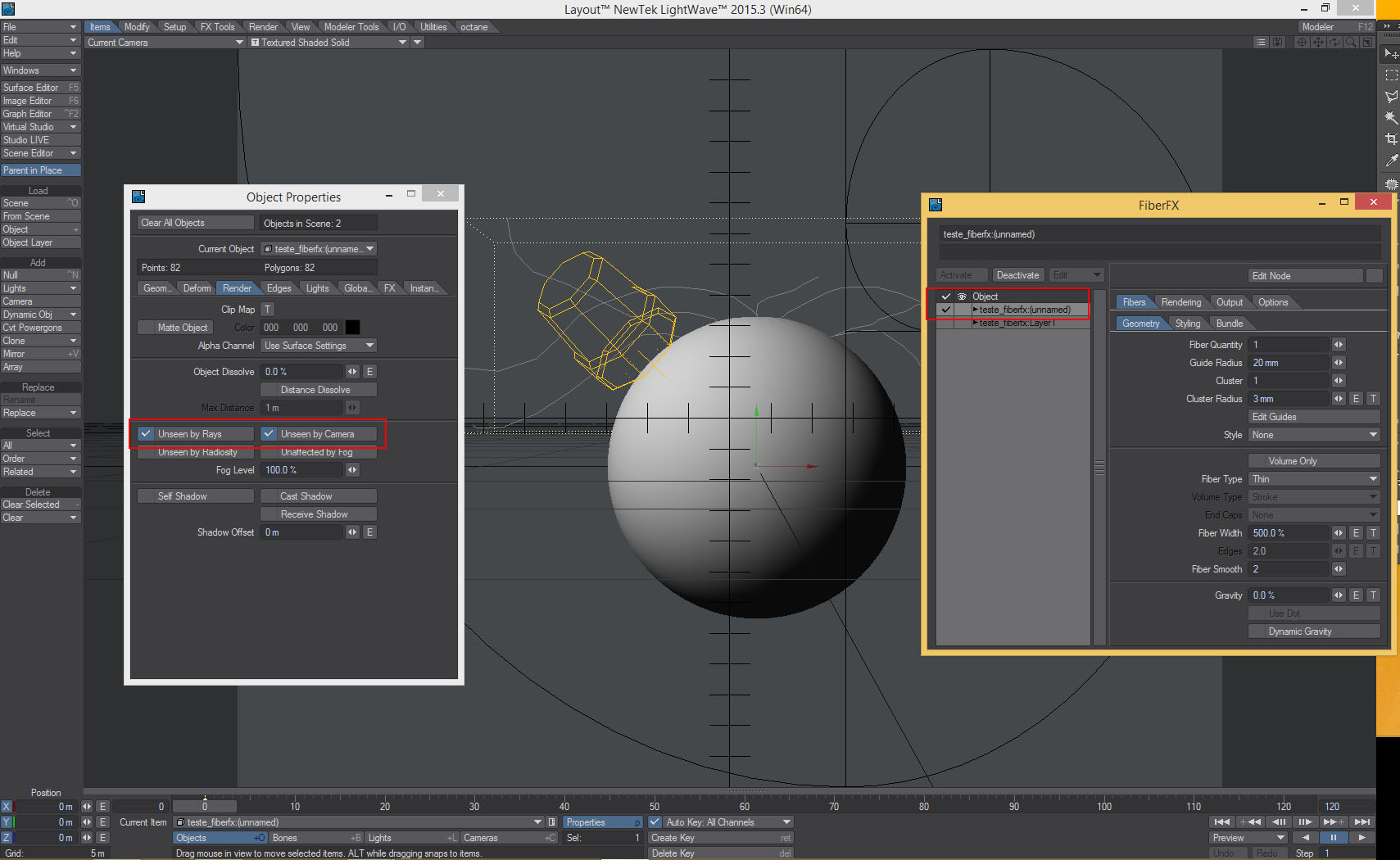

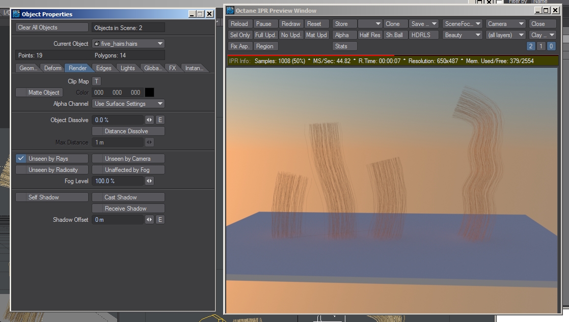

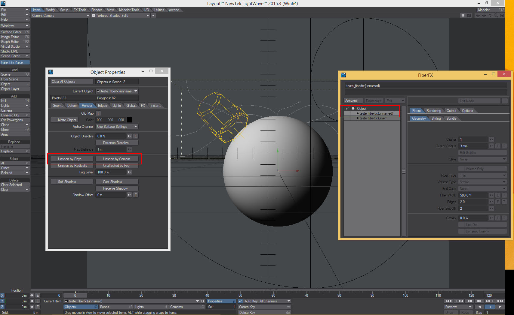

You have the "Unseen by Camera" flag enabled in the fibers object.

Thanks for your effort. I realized that is a LW issue. When you activate fiberfx, LW turns on unseen by rays, and unseen by camera.
