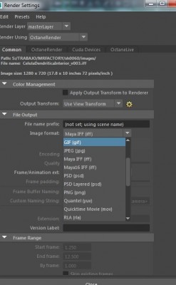

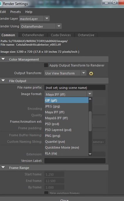

Could I render a sequence of frames from an animation to exr or hdri format?
I cannot fine de OpenEXR option in the formats list.

You need to select IFF16 or TIFF16 or any format with 16, then EXR will be the output format. :shock:
Don't forget to set the EXR options in the second tab (half float 16 bits or float 32, multichannel or not) and to disable "tonemapped HDR" if it is enabled.
:? Yes I know this doesn't make any sens, but well this is the OctaneForMaya way to setup linear workflow and render EXR.
