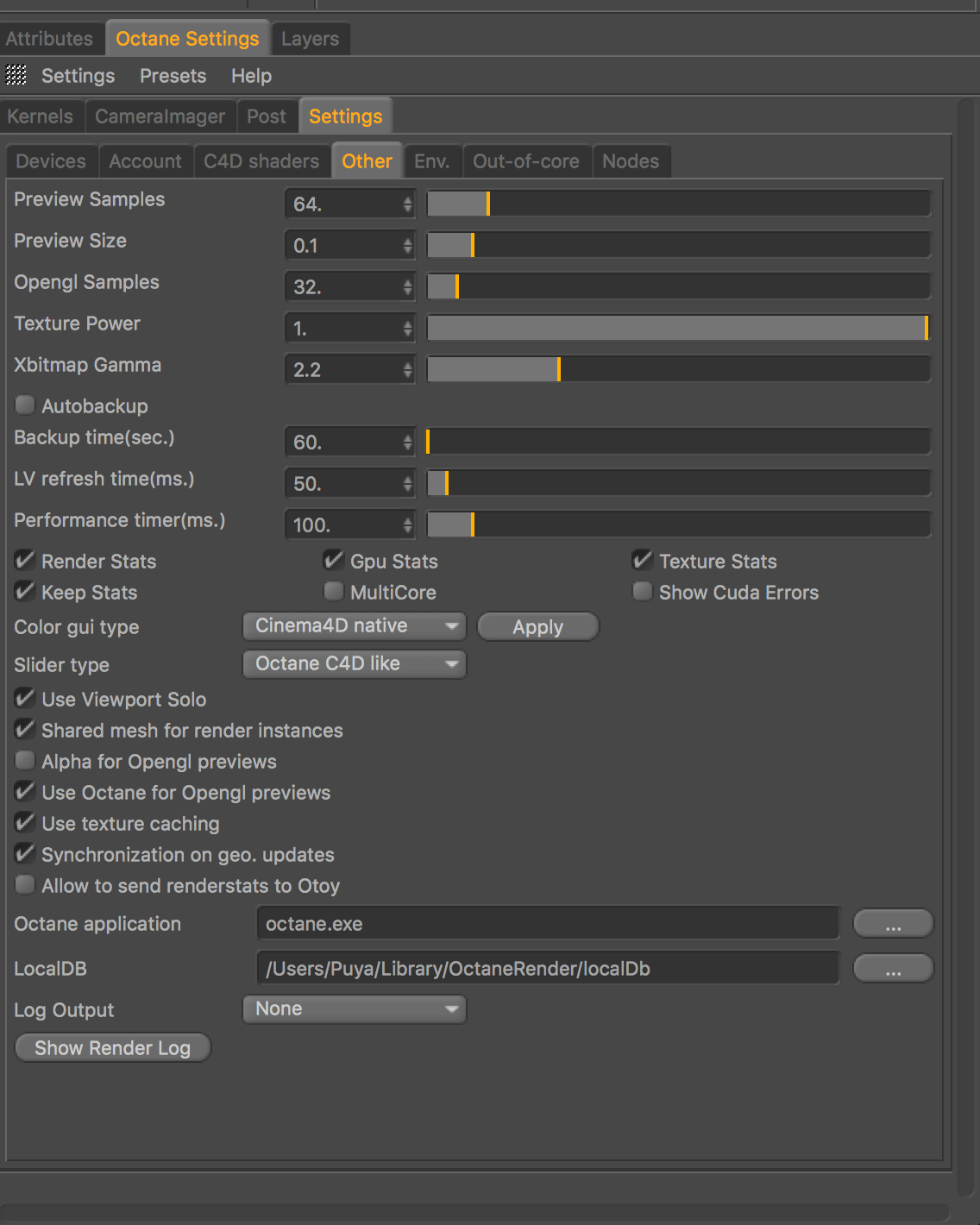

please, post a screenshot of Octane Settings/Other panel, thanks.

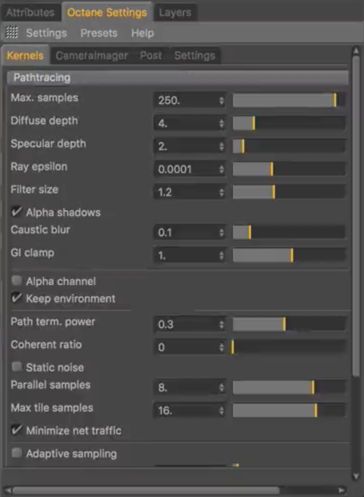

Thanks bepeg4d,

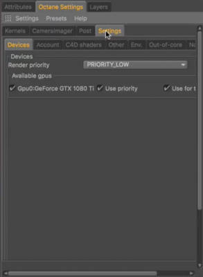

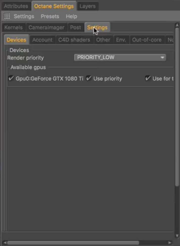

there are some shots of settings as you can also see in the video. Are there any settings that could affect the performance of the viewport in cinema4d outside of the octane viewer?

Try this parameter.

Thanks for your reply Ahmet, I tried it with or without that option, turning it off maybe changed it a little bit but it's very unnoticeable and the viewport is still very unresponsive.
I also tries with different kernels etc to no effect.
I made a short video with more screenshots of the settings, Any ideas?

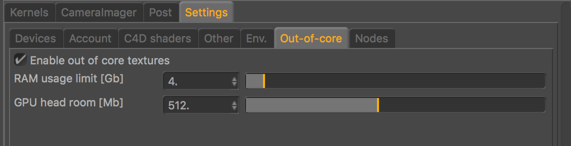

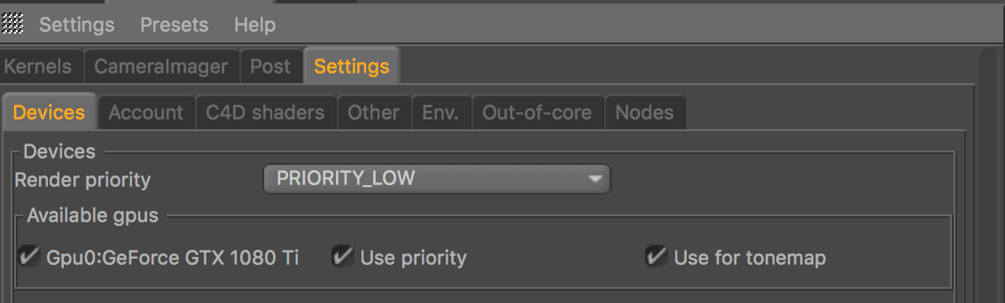

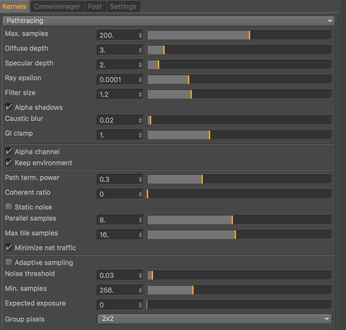

screenshots of the settings:
