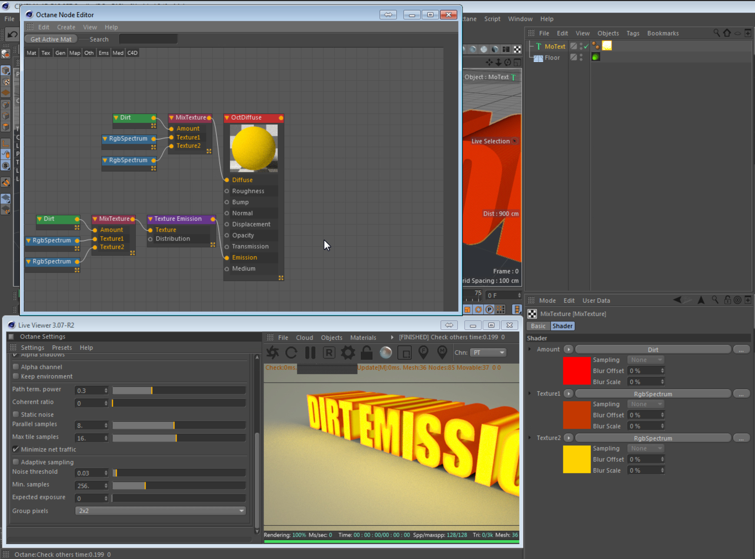

Proximal shader is not an Octane shader, and you need to bake it if you want to use it efficiently.
But you can use the Octane Dirt shader to have almost the same effect:
