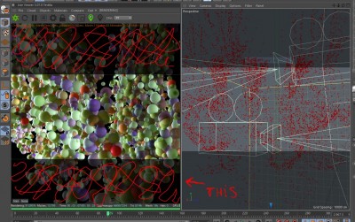

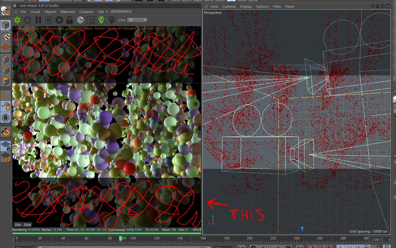

hi, i wonder if its possible to render (in the live viewer) only the matching area to the actual project ratio/size ? without messing with the Render Region option.
Beceause octane render the extra area on top and bottom for nothing, just wasting time...

Tick the "Lock Resolution" button and decrease the number that appears in the right side to scale down the resolution.

Terryvfx wrote:Tick the "Lock Resolution" button and decrease the number that appears in the right side to scale down the resolution.
You deserve a cookie!
Its a bit laggy, cause when the window is resized, the value of the resolution change but it works.
