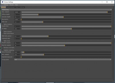

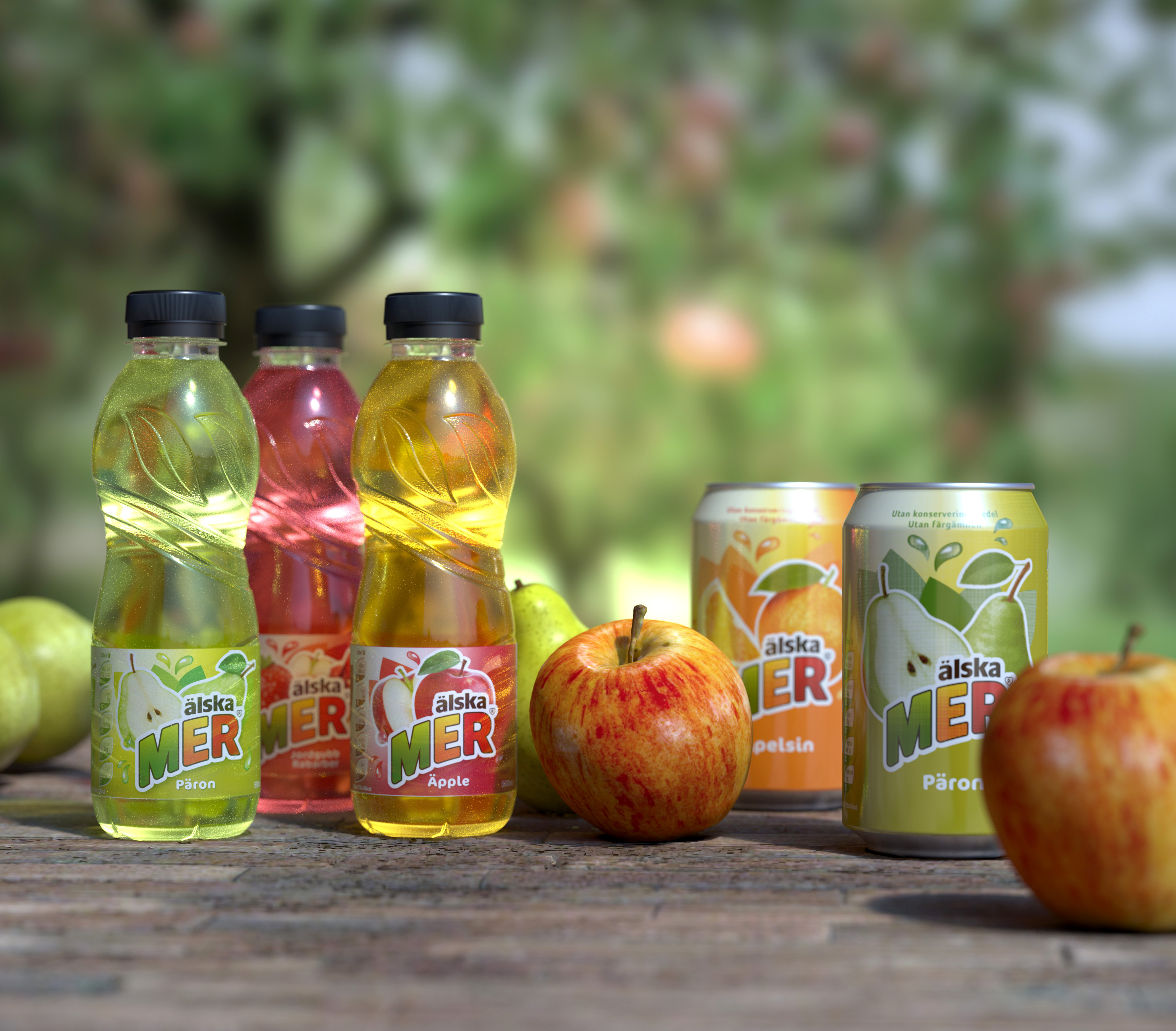

Please see attached an image I have produced. I cannot seem to get rid of the last sparklies in the top of the 3 bottles. I have set Path tracing up as I see best from the manual but these settings no matter how high the Max samples remove them.
As I understand I have Upped caustic blur, reduced GI clamp and allowed adaptive sampling to do it's thing but to no avail. Any thoughts would be appreciated.
System 6 core i7 / 32GB RAM / 2x 1070 + 1x 1080, Octane 3.06 in C4D R18

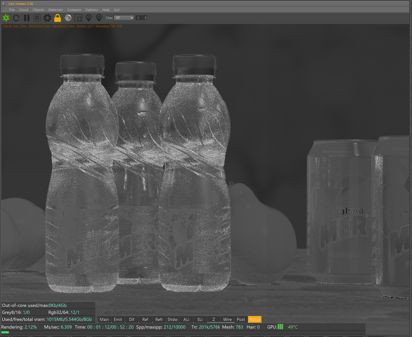

image attached showing noise

Sorry, it is possible to see the noise pass at the end of render time?

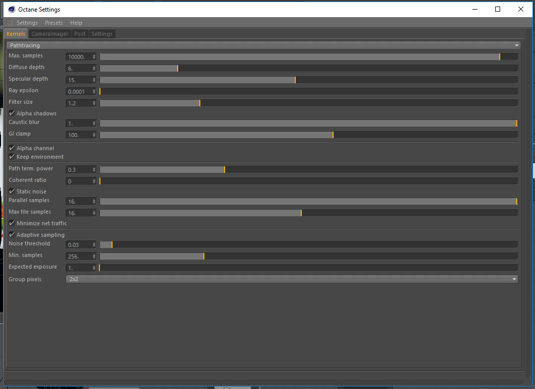

I reduced GI clamp, increased caustic blurring, reduced hot pixel value and changed the expected exposure as suggested and obtained a satifactory result.
