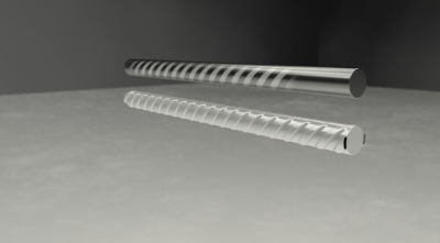

I would like to apply displacement to a rod.
Botom cylinder is having artifacts at the ends.

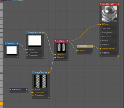

To avoid artifacts and having some of the polys disconnecting from the main mesh i would like to clamp the displacement via a gradient on th ends of the rod. I build the texture in the node editor and if I just project my displacement texture in the diffuse it looks good(top cylinder) but when I connect it in the displacement it deosnt do anything.
Isnt the displacement channel compatible with the multiply node?
Any solutions other than making the texture in AE or PSD?
Because I need to adjust many textures in this project and I would like to do it all in C4D.

i think that displacement node does accept only image for source
you can use a Baking texture node between Multiply node and Displacement node...

in Octane cinema 4d plugin Test Version 3.07-Test-- you should be able to do this
