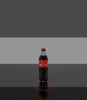

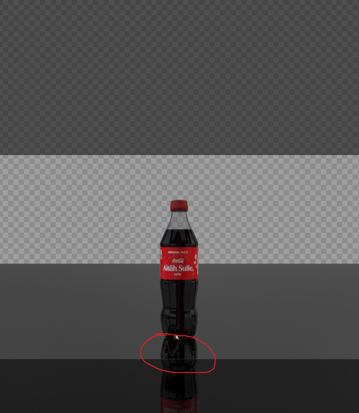

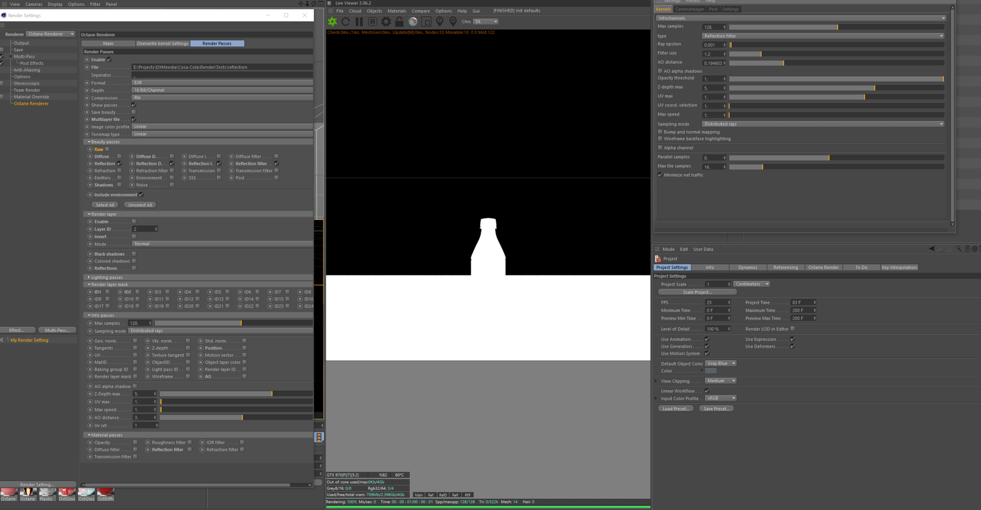

Im trying to render reflection pass seperately on ground plane (red circle). I've read bunch of the topics, watched inlifethrills tutorial on mutlipass, but still couldnt figure it out :V
What am i doing wrong/dirfferently?
is th
is th
trying to render reflection in the red circle
Posts: 16066
Location: Türkiye
Why do you select infokernel? Keep it as DL or PT and select reflection pass button in LV.
