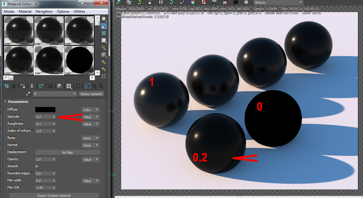

Hi SergKlyosov,
Specular map contains the reflectance information for both metal and dielectrics (non metal) surfaces. This is a key difference in the metal/rough and spec/gloss workflows. The same rules apply. You need to use measured values for metals and most all dielectrics will fall with the 0.04 - 4% range. If there is dirt on the metal, the reflectance value needs to be lowered as well. However, you can add different values in the specular map for dielectric materials since you have control to author the map.
Roughness describes the microsurface of the object. White 1.0 is rough and black 0.0 is smooth. The microsurface if rough can cause the light rays to scatter and make the highlight appear dimmer and more broad. The same amount of light energy is reflected going out as coming into the surface. This map has the most artistic freedom. There is no wrong answers here. This map gives the asset the most character as it truly describes the surface e.g. scratches, fingerprints, smudges, grime etc.
That said, you have to edit the specular node setting, using Value instead of None.
Regards
Paride

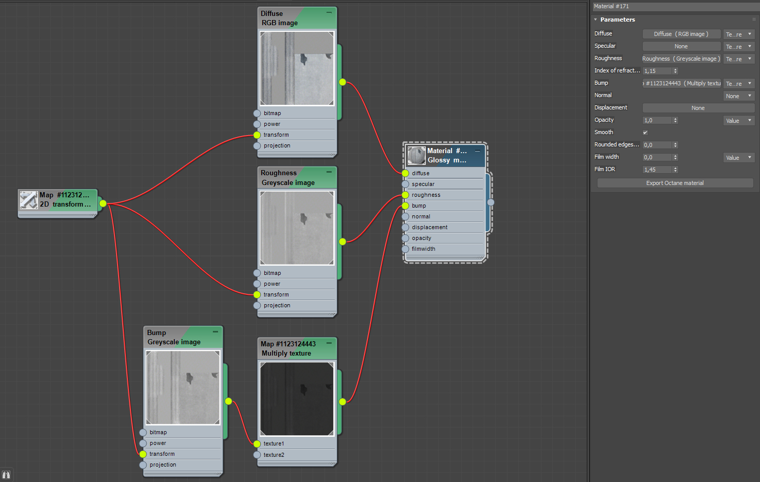

Hi SergKlyosov,
with PBR you need specular texture map, in your screenshot the specular texture map is not there, so it's like all your shader has specular 1.
to do a simple test, connect your roughness texture map to specular slot, inverting it and working with gamma.
Regards
Paride
Regards
Paride
