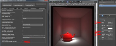

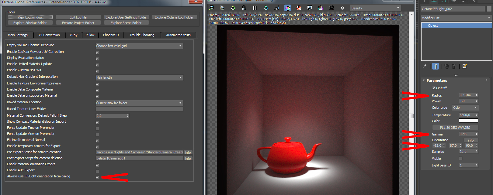

Hi darkline,
enable IESLight orientation in Octane Global Preferences, and edit IES using Gamma and Radius.
Regards
Paride
