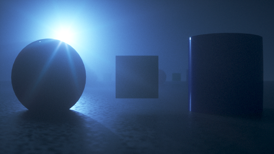

Guys, thank you all so much for pitching in here. I really appreciate it!
I actually got some pretty good results with the medium Scattering. I also played with black scatter and emissive color properties that gives you really solid Depth Cues and it is super fast to render.
I'm attaching a little experiment image here and once I have perfected the method I will post a video of the process.
Thank you all once again and if anyone has any other methods please feel free to share. I'm sure it will be helpful.

gusmendonca wrote:Guys, thank you all so much for pitching in here. I really appreciate it!
All the best!
Gus Mendonca
http://www.brushonfire.com
Looking Great !!
Sure, it would be helpful to have a video tutorial.
Also, play around with the Medium radius of your environment and the Density Scale(Scale parameter) on Volume/scatter node. The Max diffuse depth and max specular depth for ray bounce from the render setting dialog.
