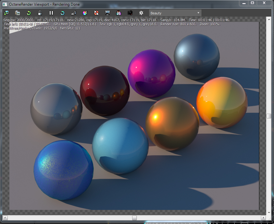

Hi Exaco,
here some carpaint material to start.
Regards
Paride
carpaint.zip
(7.69 MiB) Downloaded 1170 times

Thanks, i liked the dark blue one, was looking pretty good actually "out of the box" also i've noticed that these are made bit differently than mine, i did mine using a mirror shader as coat and base as plastic(ish) looking, then mixed with falloff.
That propably what i was doing wrong, now i just need to find/make good flakes map or try to play with these included.
Kinda happy with this one, still there's a problem to fix: black flakes, not sure how to fix that yet.
