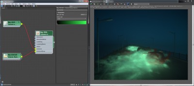

Hey all, image attached, just FYI. So i've been learning that Gaussian spectrum is significantly better at getting a more balanced look from a volume when dealing with a texture emission, I can't seem to get it to work, I only get a dull grey light.
How can I solve this?

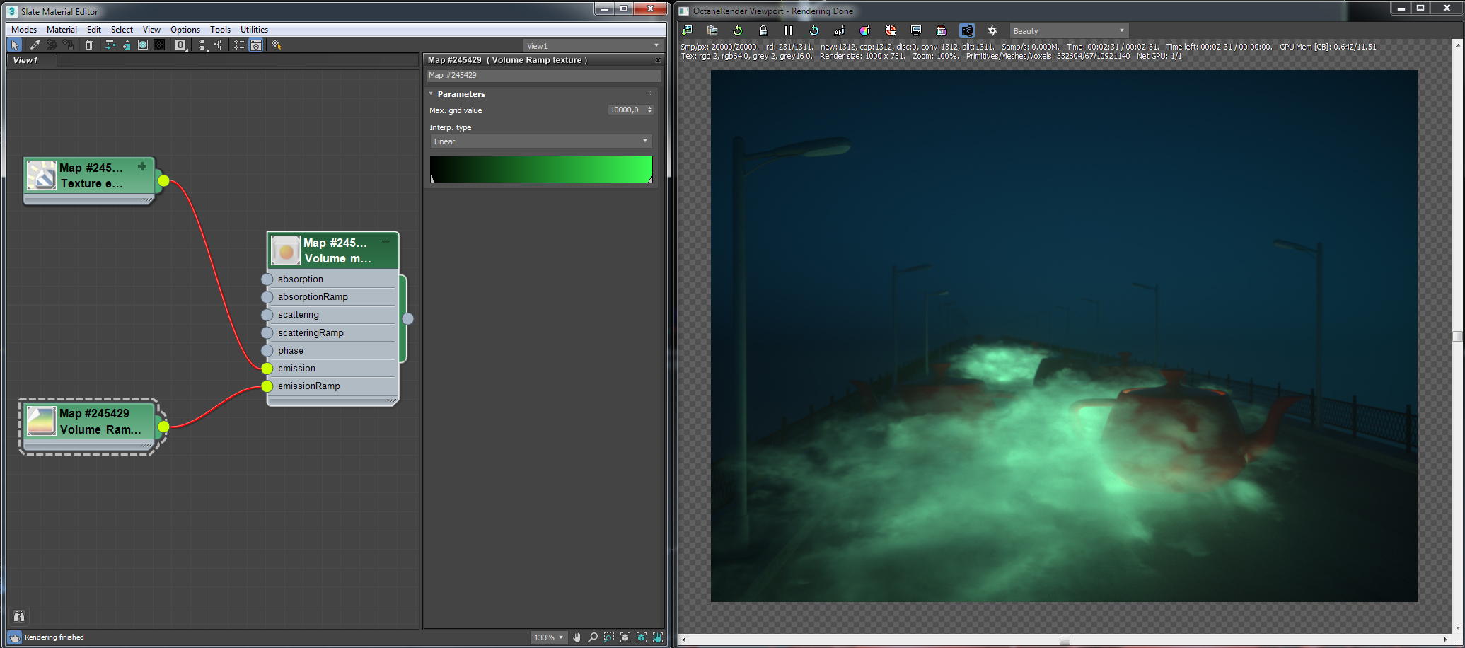

Hi Omegauser9,
my advice is to use Gradient Volume Ramp with Volumes, Gaussian spectrum node does not work properly with volumes.
Regards
Paride
