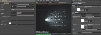

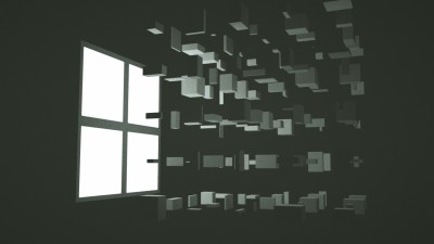

Every time I try to employ volumetrics in Octane I give up and move onto something else. I can no longer keep ignoring this feature, though. After a dozen or so attempts and hours of reading/watching tutorials on octane volumetrics, I am convinced that scattering/absorption is the least intuitive aspect of this powerful renderer. Like why is there a thickness and a density slider? Some tutorials on brograph show settings like scale, that seem to be just what I'm looking for, but for some reason do not exist in the later builds. I have tried every combination of parameter from render settings down to absorption , phase, density, and volume step length. Nothing I try achieves the one thing I am going for, the main reason anyone would use volumetrics: volumetric shadows. I'm talking about those gorgeous rays of absent light caused by gobos, branches, or anything between the light source and the floor. I have included a scene that demonstrates the problems I am having. The attached images demonstrate my failure achieving the desired effect with both a fog volume and with a sky object medium. You can see I am getting a nice bit of atmospheric depth in the image where I have used the fog volume, but no rays for some reason.

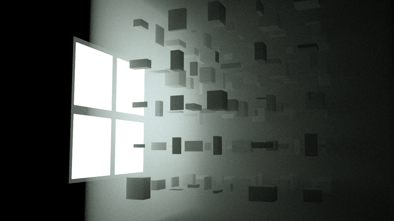

Hi Ben,
I have opened your file, disable the Volume, and re-enable the Environment node with correct settings: The Medium radius value is very important, works in meters, and need to be set in relation with the dimensions of the scene, in your case, 5m are more than enough.
Then you need a very low Density value under 1, to simulate the foggy air.
Finally white absorption, and scattering, and a bit of Phase value to enhance the scattering effect in the direction of light.
The dimension and power of the light is also important, I have added an IES file to better concentrate the light in one direction.

Thank you so much for your time. I have been able to apply these parameters from the scene you adjusted to a number of other projects with great success. I don't fully understand about the medium radius, but I am happy to have a functioning volumetric sky!
