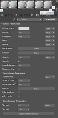

Recently, I was trying to build a complex environment in 3ds max. I’m using Substance Painter create all textures.I usually export Basecolor, Roughness, Metallic, Normal, Emissive, Maps for my assets, so sometimes there are 3 different types of materials(Non-Metal, Metal, Emissive parts) in one texture set. For such a case, I need mix 2 Glossy Material shaders by Metallic map and mix another one Diffuse Material for emission.
I know there is some other mixing method could be working with Substance Painter, but still can’t avoid mixing materials or maps several times.
I got an information from Allegorithmic Forum, there is a Metal/Rough PBR shader can be used in the standalone version. I downloaded this shader from LiveDB, and I found it works great. But it still needs to mix a Diffuse Material for Emission. Because this shader also mixed by 2 Glossy materials, it just packed as one shader.

Hi leesungwoo,
changes or introductions about new features in Octane Render must be made in SDK and can not be made by plugin developers.
So you should submit your proposals like these in the Octane Render Stand Alone forum.
Here you can find, if you have not seen yet, PBR shader for 3dsMax.
viewtopic.php?f=21&t=63127&p=322580&hilit=+pbr#p322580

I tried this scene before. It's basically okay, but this is still the same logic like I said. It seems I need to post a new request on stand-alone forum, Thank you.
Regards Lee
