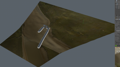

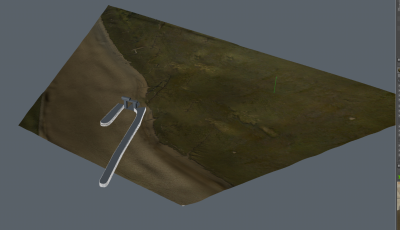

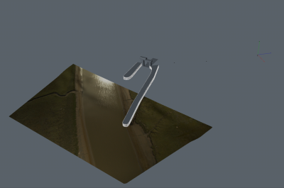

Hi aoktar,
This is an old thread I'm reviving, because a year later, I'm still not able to do something that is extremely easy to do in physical or standard render. Any help would be really appreciated!
I have a tracked a 3D camera, and from this, I'm projecting a two frames with different cameras along the path. I want to use octane, but I can't for the life of me figure out how to use two projected cameras to create a seamless texture. I've attached several images that show the first patch, the second patch and what the whole thing should look like.
I've tried baking the projections to UVW projections, to get rid of the cameras...couldn't get that to work either
Is what I'm asking even possible in Octane? Thanks sir.
