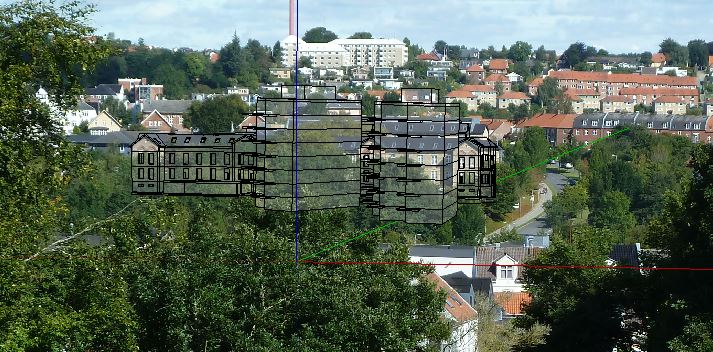

i'm also having some issues creating an photomatch, and i'm not sure how to do it :-(
as you can see, the low wide building does not have the same width as it has in sketchup - is this a settings (user) issue or does camera match simply not work?
and is there somekind of workaround for this (i have a deadline).
i have attached screencaptures from both sketchup and octane.
thanks
jorgensen

Hi Jorgensen,
please, try with this lua scripted graph:
viewtopic.php?f=73&t=63807
since it is not yet supported, it will not be saved correctly, but you can use it to obtain the render, I guess.
While in octane, select the desired Render Target/Scene view, then right click in the node inspector on any icon, and choose “Show in Graph editor".
Then right click in the Graphbeditor and create an Other/Scripted graph node.
Asdign the lua script, then copy paste the camera node from the RT to the lua camera slot, then load the background image, connect the Visible Environment pin and Film settings to the RT node from the lua scripted node, and set the desired settings.
ciao beppe

oohohohhh myy - if i rightclick on any other scene than default view - sketchup crashes.........

Jorgensen wrote: and is there somekind of workaround for this (i have a deadline).
jorgensen
You have to set same viewport size in SU and octane. Use plugin ene_viewport_resizer_v1.0.0
