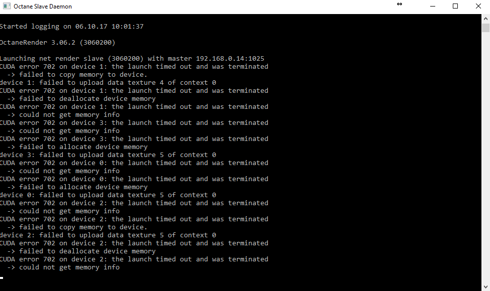

A machine I use as an octane slave with 4x 1080Ti's is repeatedly giving me the following error in the slave console.
Everything works fine until it's been rendering, sometimes for a few frames, sometimes for a while. Then I get a 702 and the console freezes.
The scene type and complexity, memory usage etc do not seem to have any effect on the crash. It can be a simple scene or very complex and the issue is the same.
The error is always a 702, but the description is sometimes different. It can be; "failed to copy memory from device" "failed to allocate/deallocate memory" "could not get memory info"
At this point it can also freeze the master (presumably it's waiting for the slave and getting nothing)
Sometimes the slave machine OS becomes unresponsive and throws a BSOD DPC_watchdog violation.
I've tried to isolate the cards and render using each of them separately, I cant get any single card to fail, but any combination of cards will fail.

same here -> kernel execution failed(report)
CUDA error 702 on device 3: the launch timed out and was terminated
-> failed to launch kernel(ptBrdf2)
device 3: direct light kernel failed
CUDA error 702 on device 0: the launch timed out and was terminated
-> could not get memory info
CUDA error 702 on device 1: the launch timed out and was terminated
