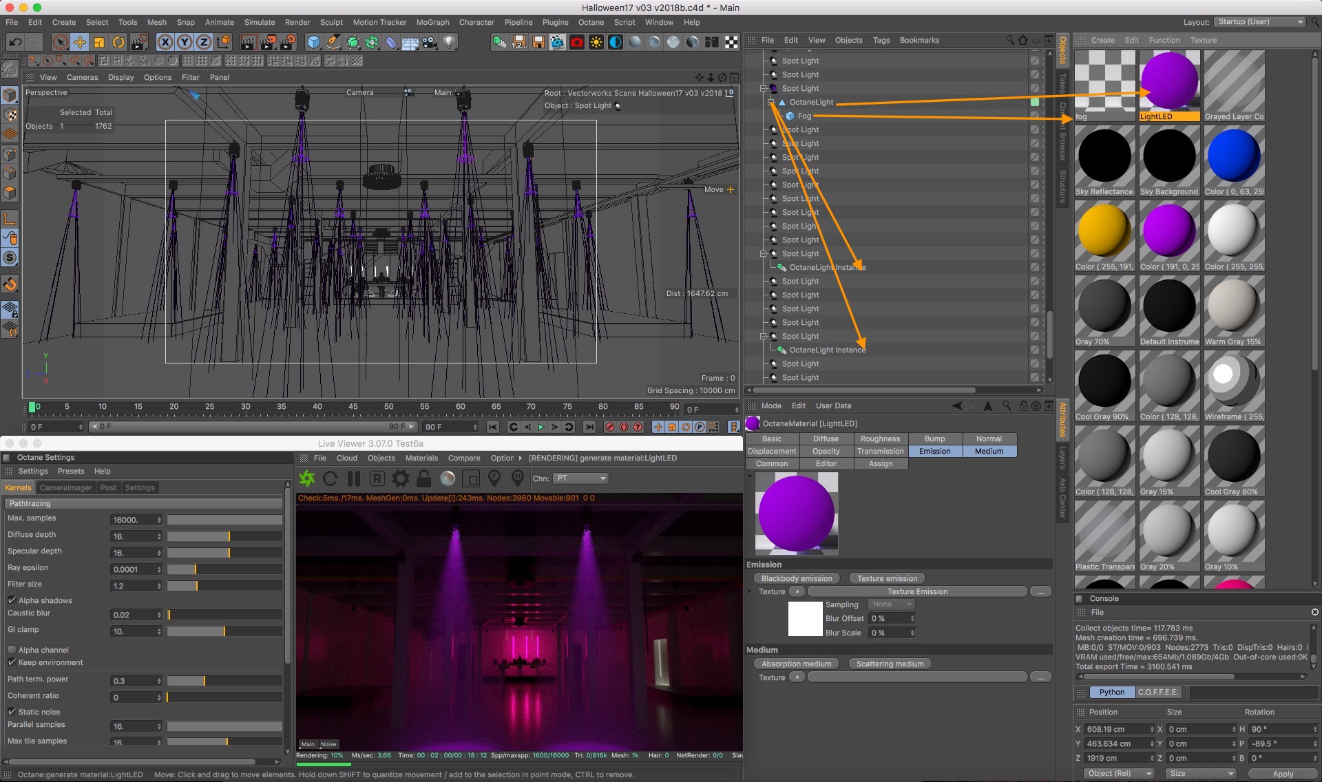

Posts: 10575
Hi Ridder,
sorry, I don't have an IES file so narrow, anyway you need to firstly switch from Direct Light AO to Path Tracing in the Kernel settings, ans use a plane for the IES light emitter, and a cube for the fog. Then you can create an instance to parent with other spotlights:
Halloween17 v03 v2018b.zip
(15.55 MiB) Downloaded 336 times
ciao beppe
