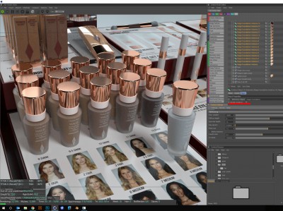

i work for a beauty company, so i have to show a lot of lipstick and other products with different colours in a precise order.
here is the problem: to give the correct colour to each product, i create the general product. i leave the colour part blank, without material.
after this i create the instance and i apply the colour to this one so as to see the colour only where i need.
if i don't tip the instance it looks fine with the colour applied, but if i tip it it becomes like the original object, so it shows up with a white/blank part.
see this example: there is a bottle with a liquid inside: glass and texture are applied to the bottle, gold is applied to the cap.
the liquid is left without material.

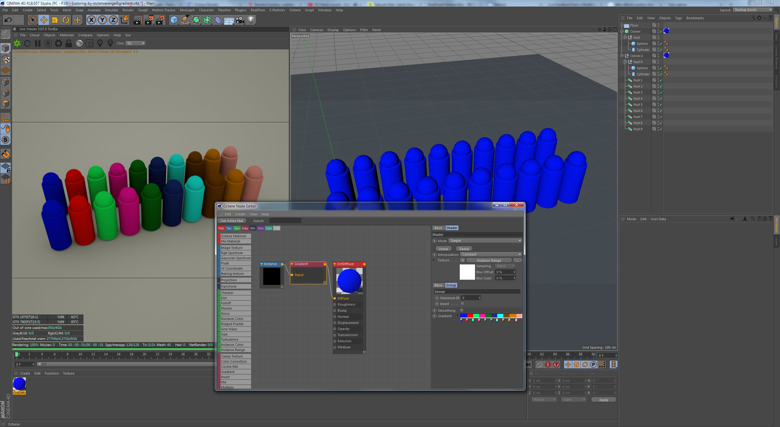

i created the instances with the colours applied. as you can see the instance render is not activated and the colours show up.
because i have in my scene too many of this objects, i'd like to activate the render instances, but if i do that, the colours disappear.
i know it's a different render engine, but for example this is possible in vray.
other thing possible is to put a render instance inside the mograph, with the render instance activated.
instead if i do this in octane, or if i forgot to deactivate one of those, it doesn't show up in the render at all.

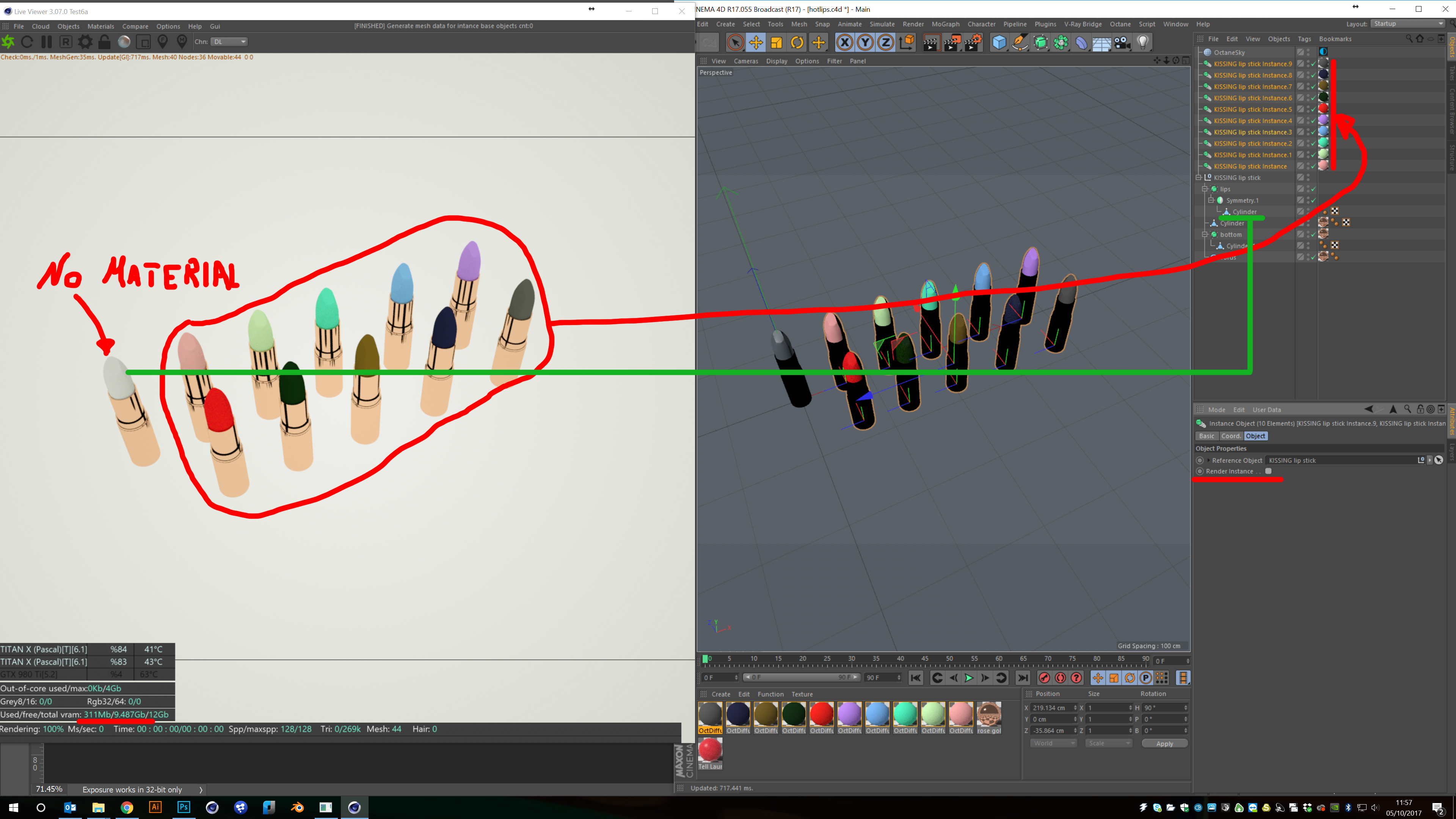

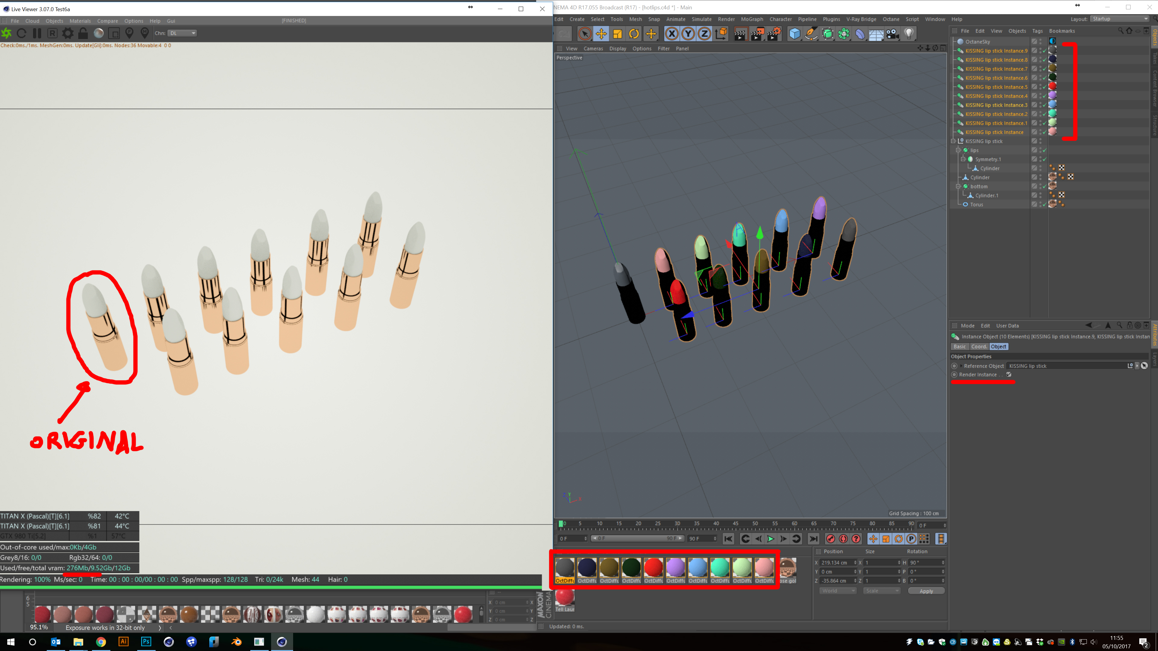

let me try again to explain the problem:
10 lipstick with the colour assign, they are simple instances, not render instances, copy basically.
like this the colour works.

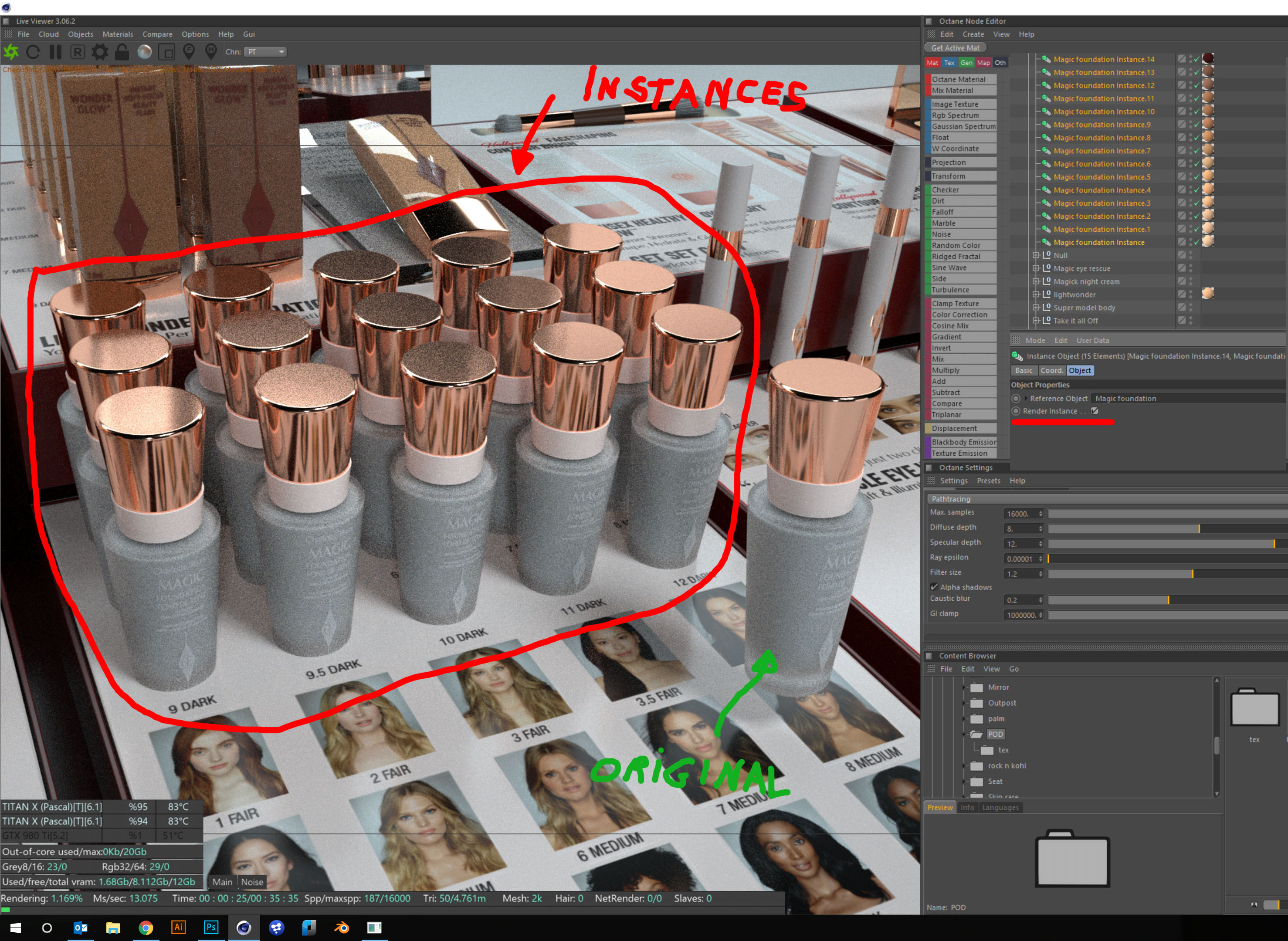

Vram occupied for this example is 311 Mb. now, i click on render instances, colour become as per the original lipstick that doesn't have material applied and is white basically, Vram 276Mb.
so i have 40 mb less. because i 1000 and 1000 of this object in the scene, and i can't use the render instances because i have to show the colours, the vram is full everytime and i struggle to do the renders.
using the tag with the ID doesn't change the situation, i mean, if i use the render instance the colour will be white, if don't use them, the colour will be fine but i'm gonna use more vram, as per the example just written.

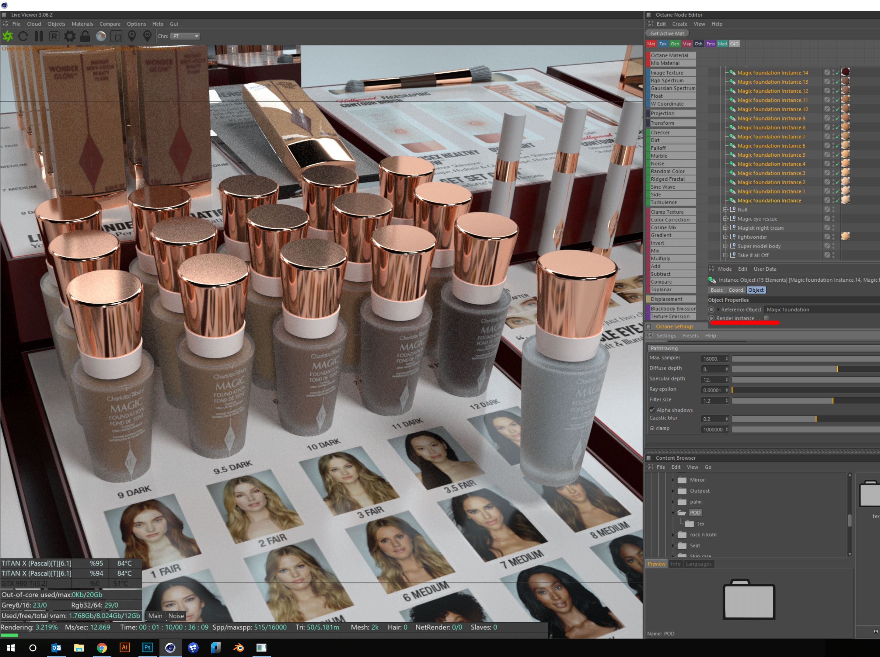

I know why/what do you wish. But assigning the instanceID will not be effective if you use render instances. See my scene how i did samething. Instances will automatically get IDs by their order and you can do a setup as in image. Let me know if it doesn't work well because i'm making a tweak on instance IDs right now.
- Attachments
- InstanceRange_coloring_by_gradient.rar
- (101.17 KiB) Downloaded 288 times
Hi Aoktar.
I finally had a chance to try your file.
it seems to work fine for what I need, render_instances + precise order colour.
it's gonna be a long conversion job, to put all the colours I have into the gradient, rather than the separated materials I currently have, but at least after that I could save a lot of space in my vram.
