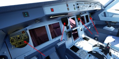

By the way, I noticed that the spot lights on the instrument panel project a black circle. Is this a bug or are spotlights not supported?
Could you provide me with a screenshot showing the issue?elecman wrote:By the way, I noticed that the spot lights on the instrument panel project a black circle. Is this a bug or are spotlights not supported?
- Rick
See the attached image. The black spots are caused by the spotlights called "instrument flood light".

Ill take a look at this.elecman wrote:See the attached image. The black spots are caused by the spotlights called "instrument flood light".
