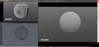

I know this has been already talked about here, and yes - I've seen the video tutorial for this, but it still doesnt work for me.
How do you render the modos native Volume Item?
I've created a simple Sphere (to be used as the source for the VDB Voxel), a Volume Item and also a VDB Voxel Item.
I've hooked up the VDBVoxel Node to the Volume node in the Schematic. And I've set my Sphere as the Source Item for the VDBVoxel.
According to the video this should be enoght for the plugin to translate this to Octane.
So here's what it looks like in modo vs. Octane
I'm also attaching the scene file should this help.

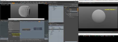

Hey Paul. Thanks for taking the time to investigate. Unfortunatelly for me it's still a no go.
I just get the spehere rendering, no Volumes at all.
I've got to admit that I wasnt working with the latest Octane version :oops: (I was on 3.04) but as soon as I noticed - I've upgraded to 3.06, but it's still not that.
Can you send me my scene back after you modified it?
Another problem that I'm having is that after I create a Node Graph - when I click Edit Node nothing happens. No windows pop-up in order to modify the node. I've even tried opening Octane standalone on it's own along modo but that doesnt do anything at all either.

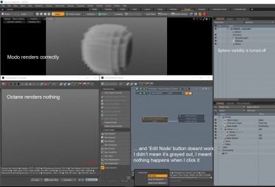

Paul I've followed your instructions as close as I possibly can.
The screenshot you mentioned that my sphere visibility is turned on - yes, because I'm trying everything that comes to mind because it doesn't work for me when I follow your workflow. I, of course, tried this as well with the Sphere visibility turned OFF.
check the screenshot please.
I've also tried turning on and off the 'Live Geometry Update', I've tried turning on/off the "Use modo render cache" in the settings.
The only thing that kinda worsk is 'Generate Voxel Mesh' in the VDBVoxel settings. but I just get this weird geometry, nothing 'smokey' visually.

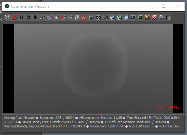

If I load the scene you sent me into Modo 902 SP3, then turn the visibility of the Sphere item OFF, then open the Octane Viewport (with plugin version 3.7.0.125), I get the following, which is definitely showing a voxel item rendering in Octane.
Regarding the Edit Node button - it will do nothing if that Octane Override material is not connected to a Mesh item in the Octane nodegraph.

Ok, with the latest TEST version indeed it does work now. I was on the Stable version of the plug-in.
