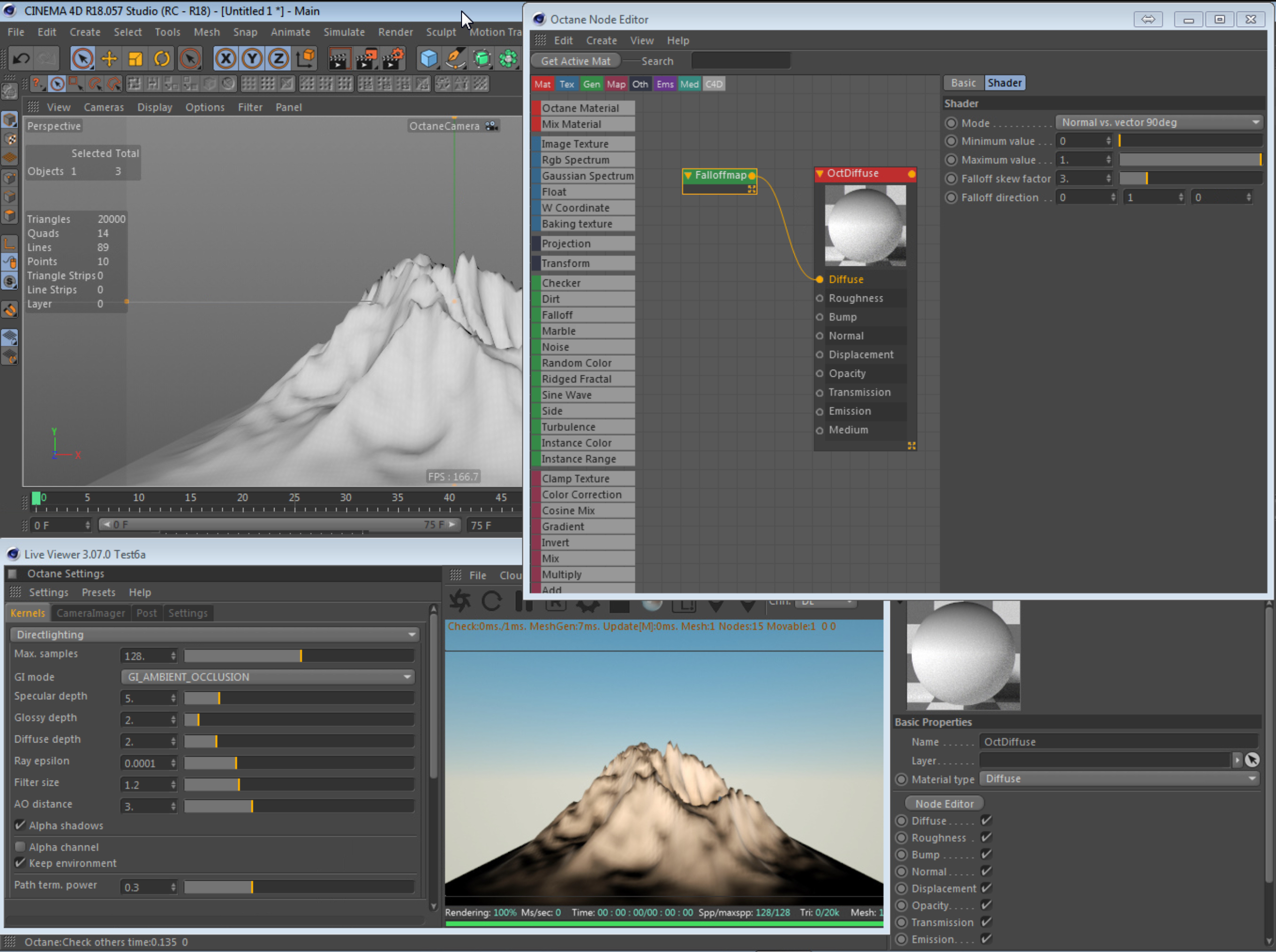

Posts: 10611
you need to use the Falloff node, but you need to change the mode to Normal vs Vector 90deg:

It's working as expected for Octane plugin. Please read my following explanation.
When you use C4D shader you should understand how they can work. There's not any possibility to directly run these shaders in GPU. So they are rendered to bitmaps and used as an image in object uv space(u=0...1, v=0....1). So you should not expect a proper results if these shaders are using world coordinate system or camera_normal/surface_normals. This is the reason why you cannot get any results as you expected. I hope this explanation is clear.
