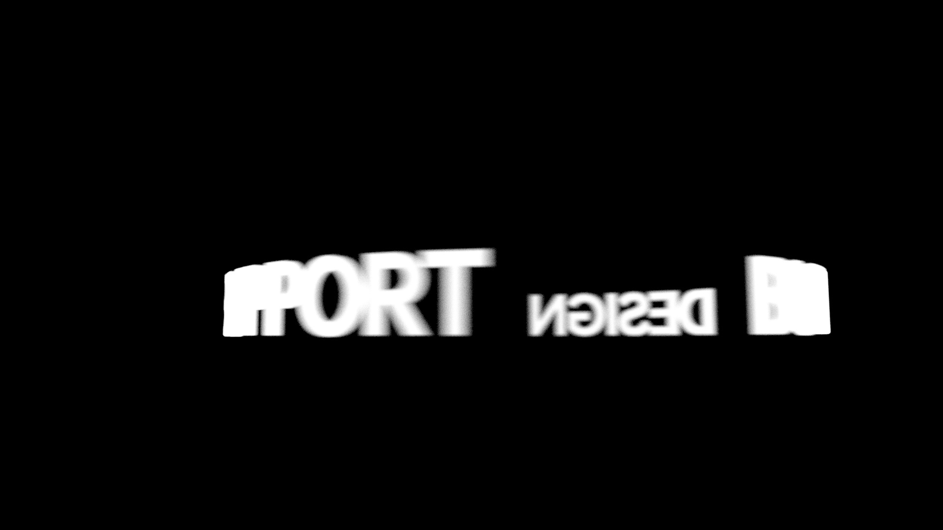

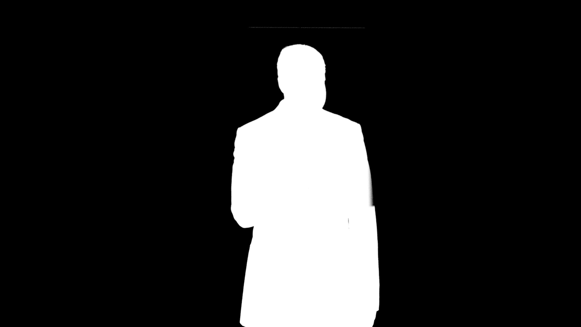

Thank you for chiming in. Its client sensitive, but attached are some screens to check out. I need to knockout the type behind him in the matte, but only the type behind him. Sometimes the type is in front and behind at the same time. That is where my problem is.
Object A:
Object B:

Hi MontyVFX,
which way are you using to get your masks, Render layer masks, or object layer color?
ciao beppe
