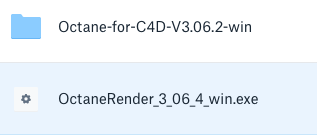

Sorry to bother u again with this, but do i have to use exact same version like eg. Standalone 6.02 and c4d plugin 6.02 or doesnt matter? Im asking this cause i noticed the latest c4d stable plugin doesnt match in name the latest stable standalone. Thanks
take a look at the image attached. the lastest c4d stable version leads me to this standalone version.

Hi thanulee,
sorry, my fault, I forgot to mention that plugin and Standalone need to match and have the same SDK version.
So you need to use Standalone 3.06.2, since c4doctane does not have a 3.06.4 version.
ciao beppe
