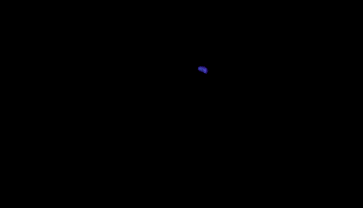

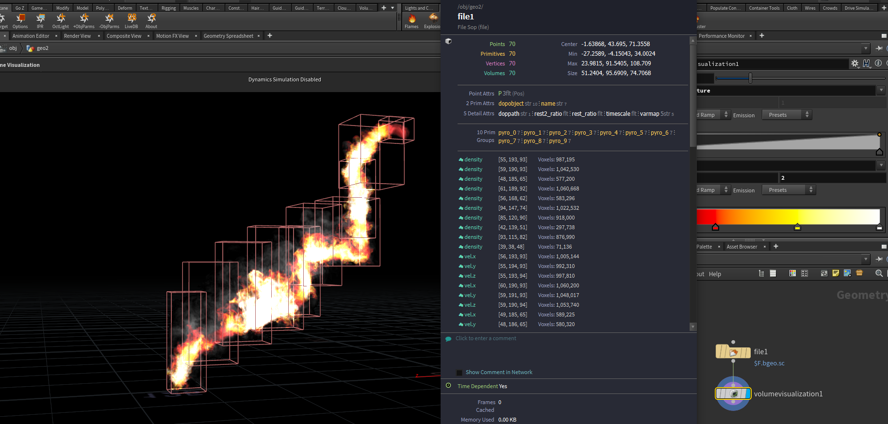

I made a pyro simulation using clustering to optimize the simulation. However, when I try to render the clusters, only the last one seems to be rendering. Is there something I need to do to render all the clusters?

Sorry, this feature is not supported by the Octane plugin yet. Currently, only one grid of each type is extracted from a single Houdini node because the plugin only builds one Octane volume object from each node.
To support this kind of clusters with multiple volumes primitives the plugin must build an Octane volume object for each one. I'll try to add this feature to the next plugin build.

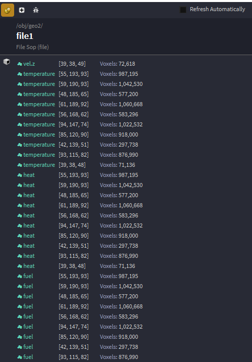

Thanks! I'll take a look at it ASAP. Support this feature should be possible because I've seen in your scene that each cluster is assigned to a group, so it is possible to know the grids that must be used for each Octane volume from the groups.

I figured out a solution in case someone else needs help. Just use blast node and select the prim_x group and then delete non selected. Save the selected group and repeat for each cluster. If you set the group name to "pyro_$F" then all you have to do is set frame range to and press play.
