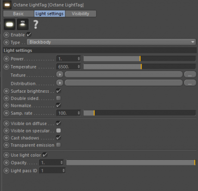

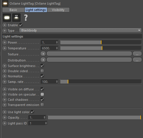

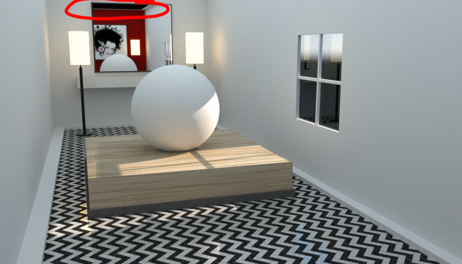

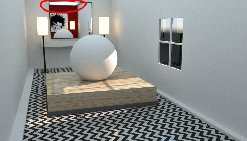

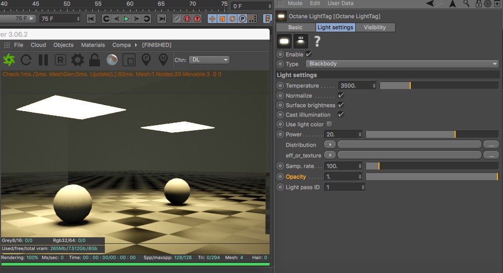

Is there a way to remove an area light from a mirror reflection as shown in attached image, you can remove the "visible on specular" but not the area light object as shown
Posts: 10606
HI TMBPC,

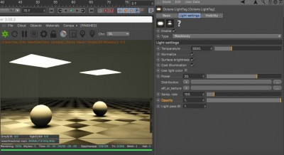

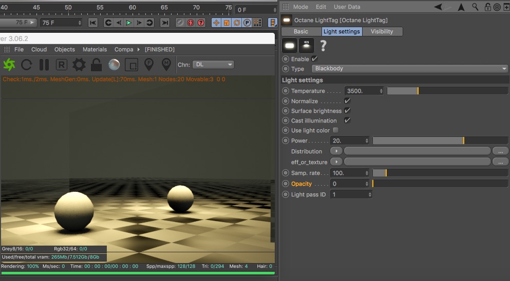

we have solved the issue at customer support, but just for other users, it is necessary to bring the Opacity slider to 0, in order to hide an Area light in reflections:
