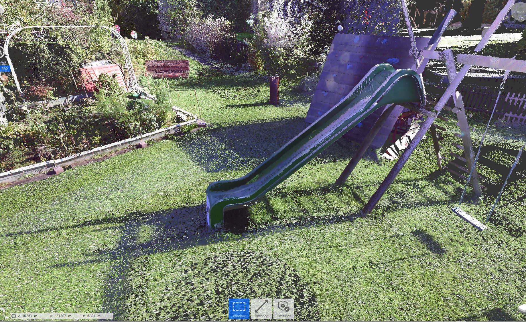

edit: here a screenshot straight out of recap to show what quality the point cloud is:
pointcloud
pointcloud
