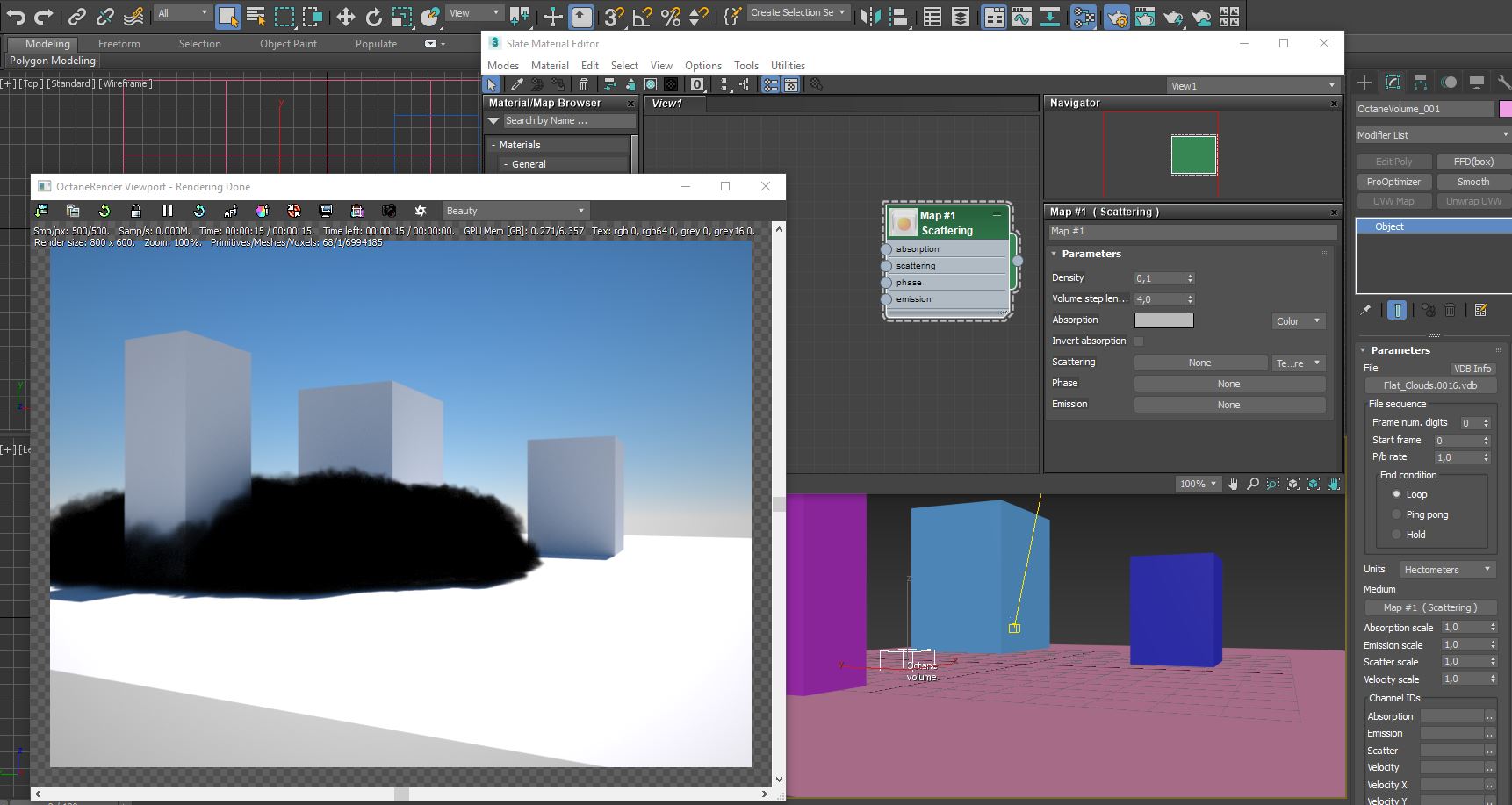

I'm having some troubles setting up a volume with a proper look. I'm using the medium slot in the OctaneVolume but have no effect on it. I've attached an image with the setup.
Am I doing something wrong?

you should add scattering node, try to take a look here:
https://docs.otoy.com/3DSMaxH/3DSMaxPlu ... ght=medium

Oh, thanks!
Absorption was the secret.
