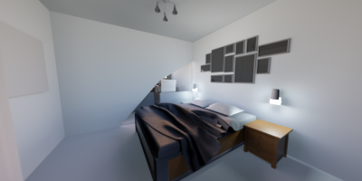

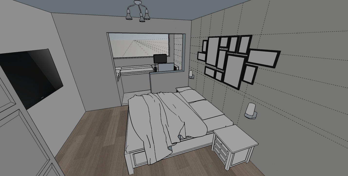

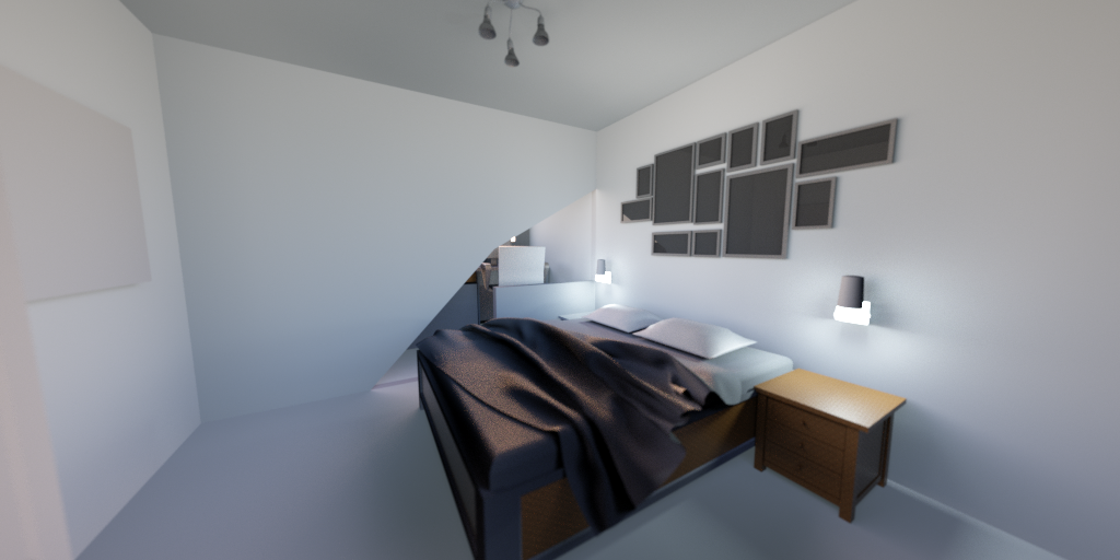

Hello guys,
I am beginner and using Octane standalone version with Sketchup 2017. When I tried to import .obj file from Sketch, I faced objects visualization issue. As you can see, wall transfered with incorrected geometry.
Sorry, if this issue already solved and published here, but i found only solution in separating objectes, where more then 4 angles to few triangle walls.
Thanks in advance!
After import
After import
Before
Before

Hi Noimius,
you need to tick the Triangulate all faces option while exporting.

@bepeg4d Thank you vey much, it works correcltly now!
