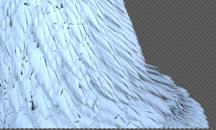

Hello, Could you please help with a transparency problem (opacity map), today I bought Octane render and I tried to render feathers on a chicken. I am a attaching picture with a problem. Thanks in advance!
P.S. its a problem with multiple opacity maps on top of each other (with single opacity maps its okay)

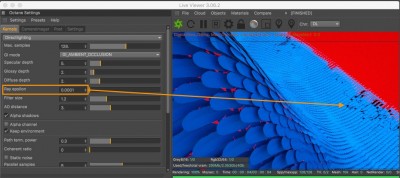

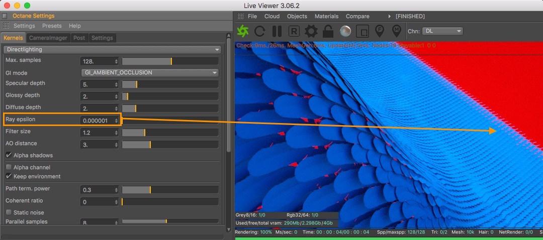

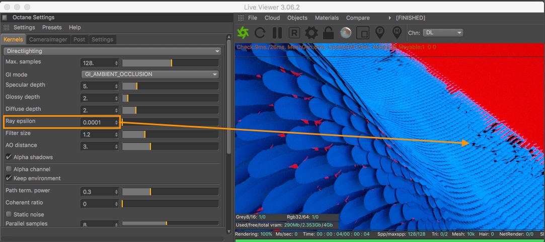

Hi clicky,
maybe it's a scale/ray epsilon issue, please, look at the attache images:
