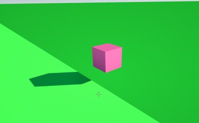

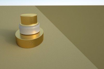

Two issues I noticed:
(1) Infinite Plane comes in at a 45° angle and it is necessary to rotate it to X:90, y:0, Z:1.
(2) More serious issue - Infinite plane does not render correctly when panning around for a full 360 - it appears to get cut of in the back with a sharp line and a darker color. Also - an object's shadow gets cut off and does not render correctly towards back of plane.

pegot wrote:Two issues I noticed:
(1) will be fixed in the next release;
(2) I cannot reproduce it. Could you please upload your scene? Thank you.

DrawFun wrote: I cannot reproduce it. Could you please upload your scene? Thank you.
Sorry for the dely. See attached for blend file and also a screen cast movie showing the issue.
