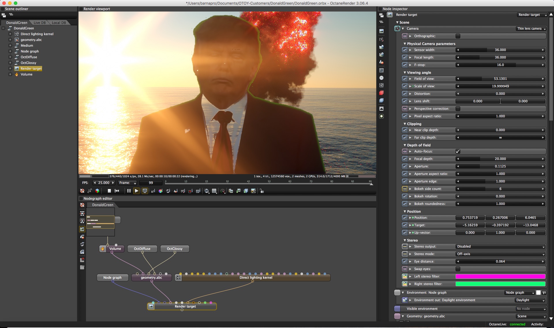

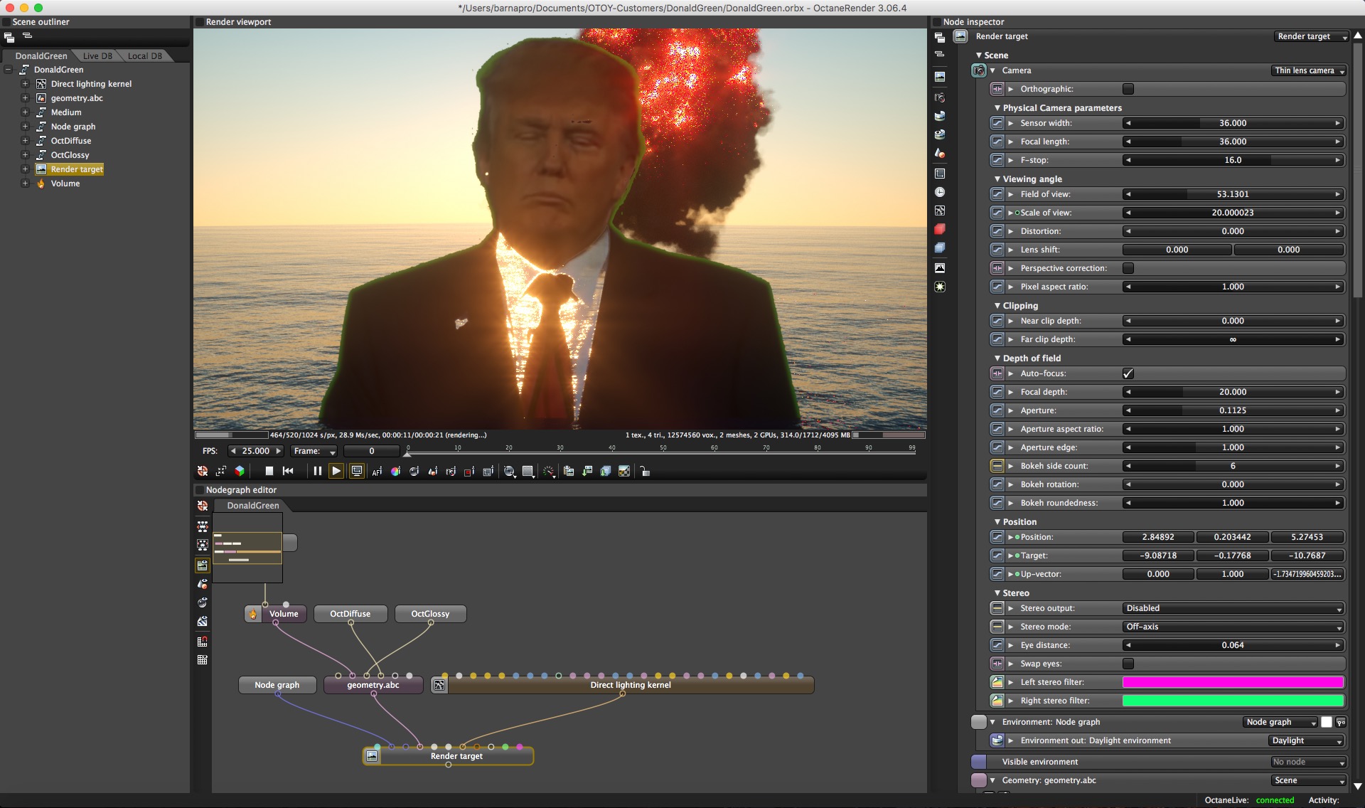

Hi adamrg7,
I meant something like this, sorry for the poor, terrible, and exagerated example: ciao beppe

Hi adamrg7,
yes the plane is parented to the Camera, so they are moving together. The greenscreen is used to get the mask in opacity, if you prepare it in a compompositing app, you can make a precise mask. Alway better to use animated image sequences, video codec can change a lot the quality of the frame.
ciao beppe
ciao beppe
