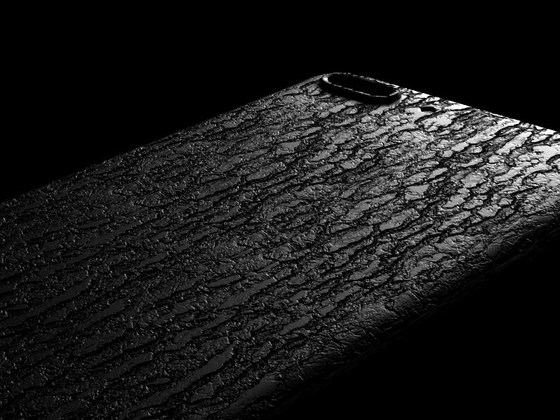

Not sure if it's just me or Octane actually lacks the capability of making procedural textures compared to other renderers.
I am trying to recreate this material: https://youtu.be/27fYPFSkOSU?t=59s played with all various maps and it's not even close to the look, feels like im lacking some more options or even skill.
Maybe some experienced Octane user could check the material and tell if its possible to recreate nearly 1:1 look in Octane for Max alone ? Or i will need 3rd party software such as Substance Designer to make it ?
My attempt so far: https://www2.pic-upload.de/img/33945096/Untitled.png ( no idea how to make the cracks )

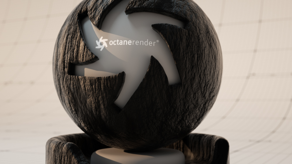

Hi Exaco,
attached a material, using RGB map, to modify it as you wish.
I do not think is a good way using procedural textures, because you can not use them in displacement node (with Octane 3.06x).
Bump texture map is not a good way for macroscopic texture.
In Octane Render 3.07x you will have a baking node texture that will allow you to use the displacement node with procedural textures,
and in Octane Render 3.08x, with OSL, you will be able to create and use many types of procedural textures.
Regards
Paride

Exaco,
this is a another material, using bump node, as you will see, will not be optimal without displacement node.
you can also make a baking texture with 3.06x, but with 3.07x baking node texture process is simple and immediate speeding up your workflow.
Regards
Paride

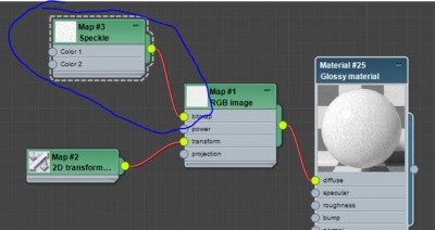

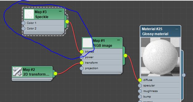

BTW you all do realize you can use all of the 3dmax procedurals, it's a half hack though cause it bakes it every time you use it, so it can become slower.. (didn't notice it), but you can plug in all of the stuff that works in the standalone - even substance material

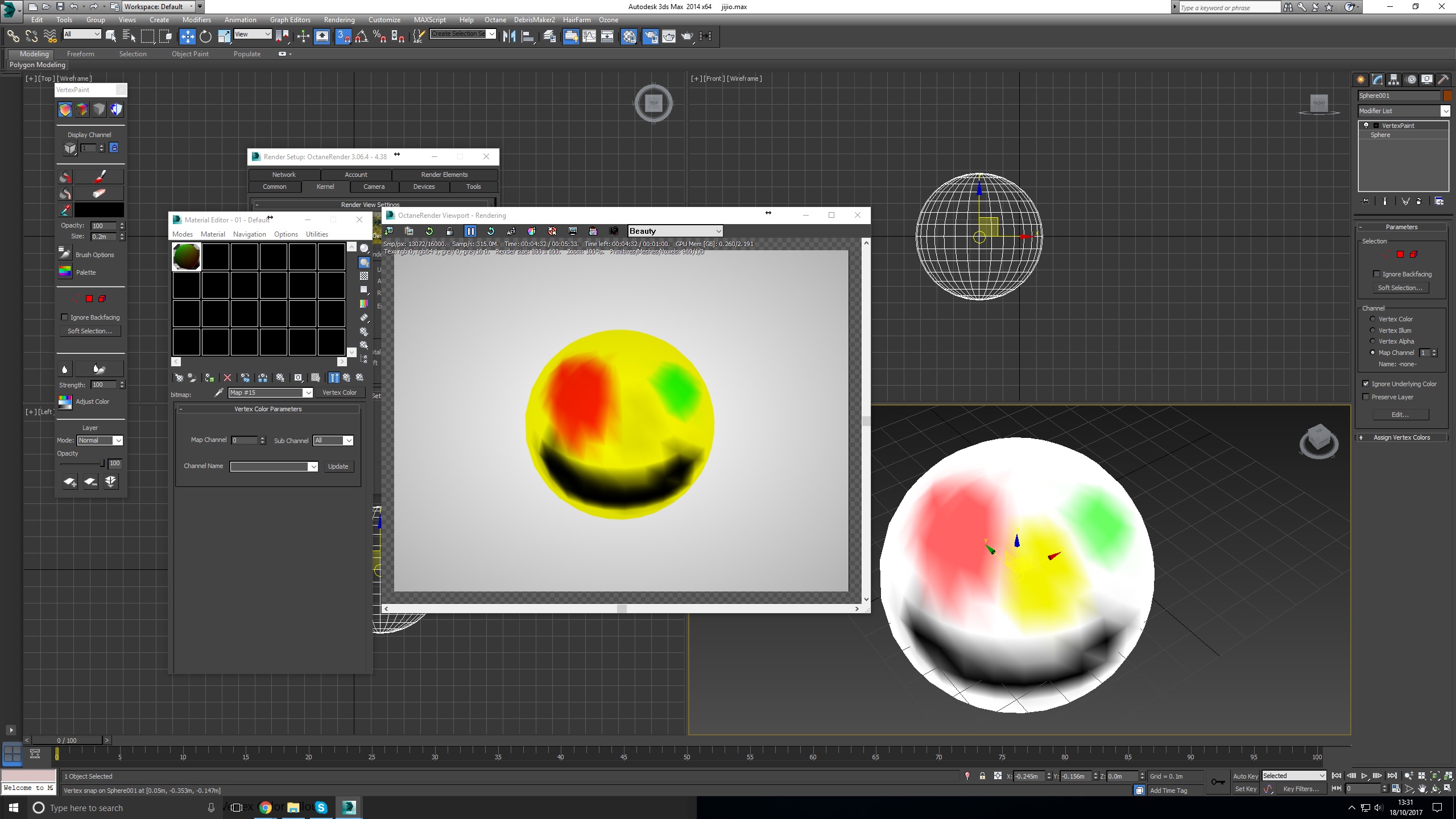

I had no idea this could be done, it's a very cool way of rendering Max's procedural textures. It seems to work well for things like noise, but is there a way to get the Falloff texture working properly? It does render something, and surprisingly even the mix curve affects it which is great, but the falloff doesn't seem to be from the camera position, and if I change the falloff to be relative to an object, or to use a different axis it just renders one colour. I can imagine it wouldn't work for the light / shadow falloff, but if it can use towards / away objects and different axes that would be fantastic.
Since reading this post I've done some testing as to what does and what doesn't work. In the reply above I mentioned about the limitations of the falloff texture, but I'm also having a problem with the vertex color texture. I've attached a screengrab to show the problem. Essentially when the vertex colour is white Octane will render it as yellow.

Hi Rico_uk,
what are you trying to do?
Regards
