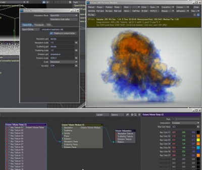

Hi I was studying Octane Volumetric objects, and I saw an example from facebook page,
https://www.facebook.com/38689510140878 ... =3&theater
So I tryed to replicate this. But I am not very succesfull, and I am getting strange results. I am attaching the scene, the vdb file that I am using is from http://www.openvdb.org/download/
Can anyone help me?

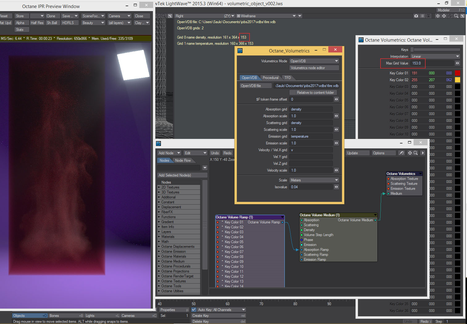

the resolution has nothing to do with max grid value in that case....
this fix just uses emission instead of setting up a ramp
volumetric_object_v002.zip
(6.26 KiB) Downloaded 256 times

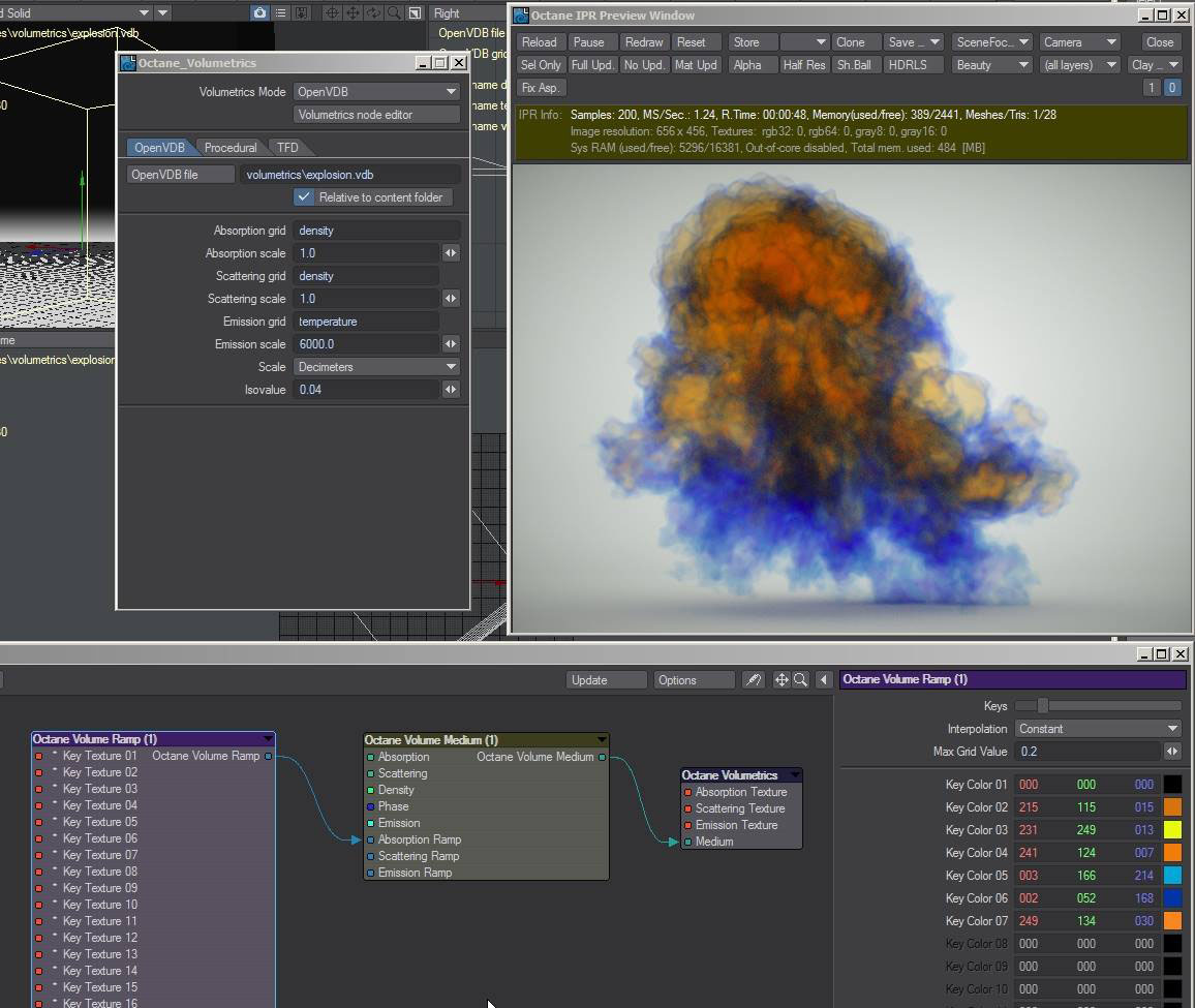

This is the original scene, if you want to play with it. You only need to set the VDB file.
Thanks,
-Juanjo
