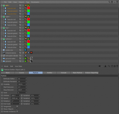

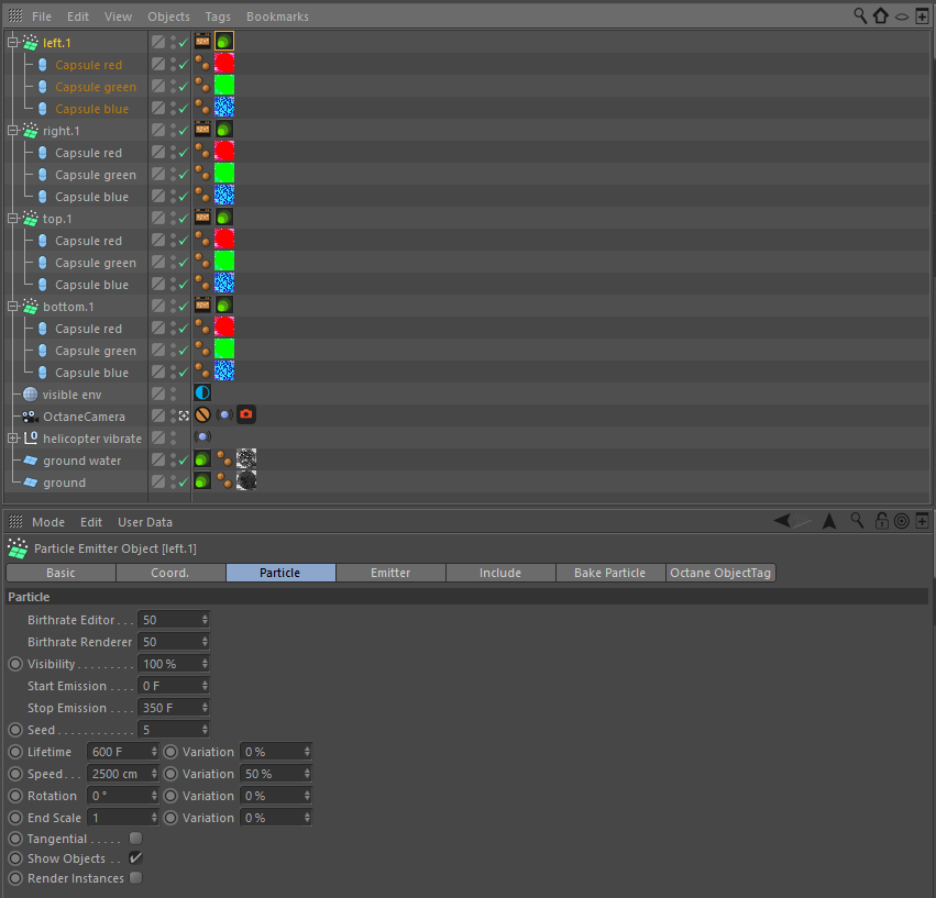

Basically, could you tell me what is the proper setting of the particle emitter, I am confused with Xparticles setting that I saw in the Octane manual ~~
You can see attached my current setting (same setting for the 4 emitters)
Thanks again,
Jeremy
Thanks again,
Jeremy

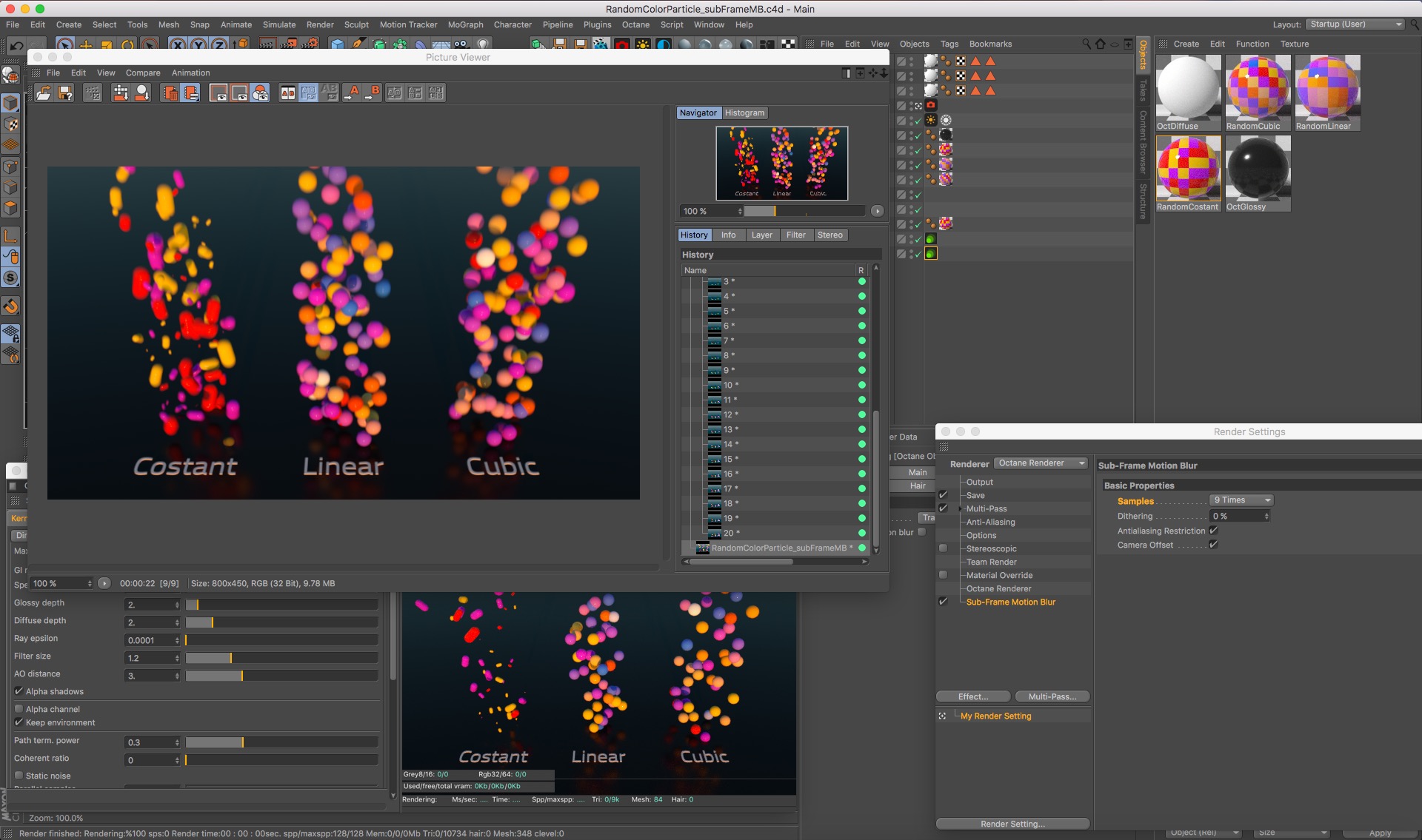

Hi Jeremy,
basically it is independent from the settings of your emitters, since it's a rendering effect that merges multiple subframes in one blurred result.
Please, have a look at the attached scene: ciao beppe

Hi Jeremy,
sorry, my mistake, I have taken an old scene prepared to check the three different options in the Random Color node, Clamp, Linear, and Cubic, and only applied the SubFrame Motion Blur option in Render Settings and divided the Max Smples with the number of passes.
I have checked with stable v3.06.2 and the Subframe option works well, but has issues with 3.07-test-3a.
ciao beppe
ciao beppe
