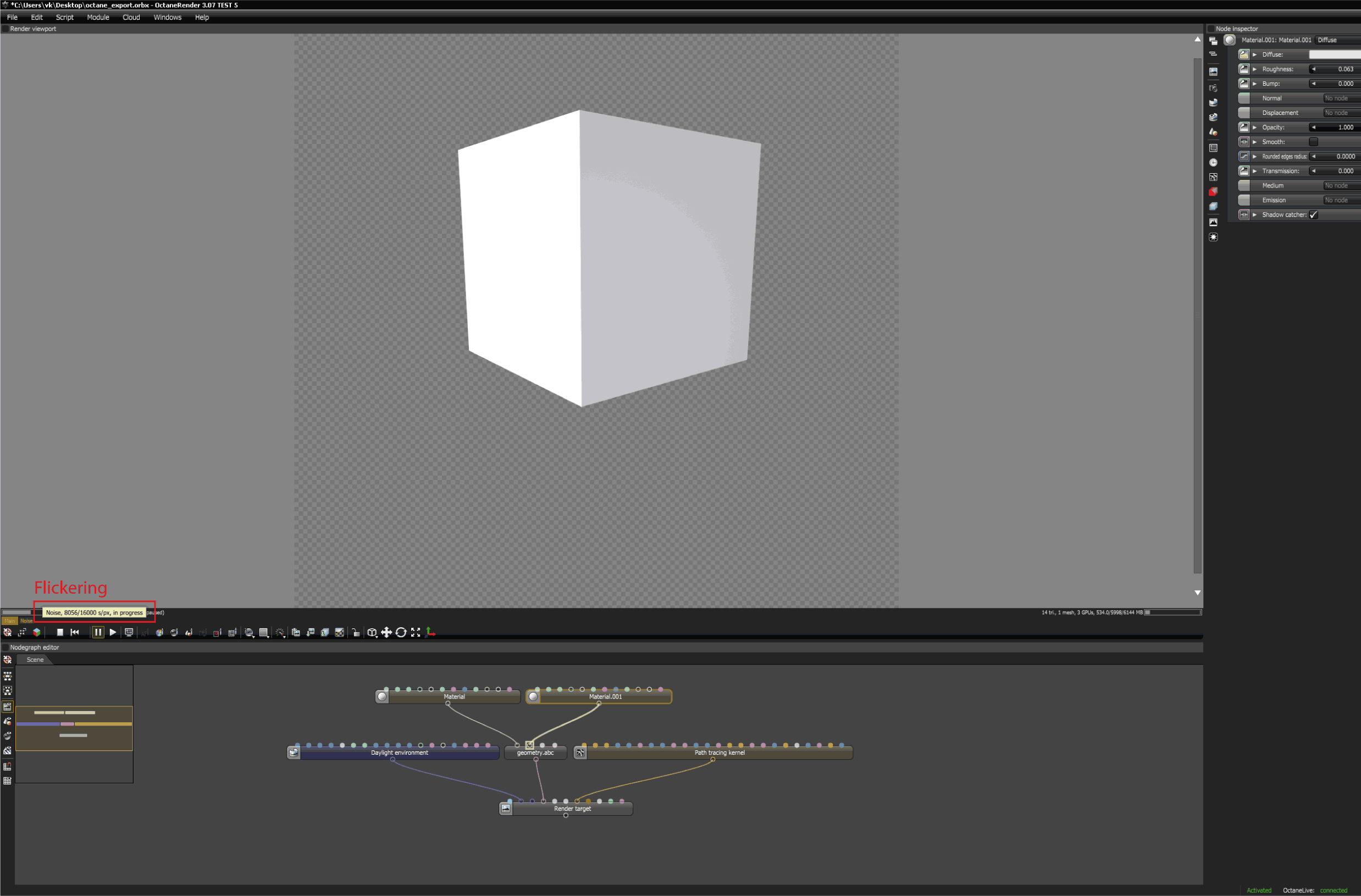

I encountered two issues with this release:
- shadow catcher isn't working
- tool tip on the layer tab of the render viewport starts flickering after a view seconds.

aufwind wrote:thanks for the update.
I just tried it and here it works. Do you've got any lights or an importance sampled environment in your scene? Or maybe send me an example scene showing the problem.
You mean the render passes selector at the bottom of the viewport? Can't reproduce it. What do I have to do to reproduce it? Thanks.

Picture + Scene for testing

Thanks for the scene. The shadow catcher option seems to be not working if the smooth option in the material is switched off. Still can't reproduce the flickering though. Will try tomorrow at work.
EDIT: Ok, the actual problem seems to be that the Alembic file is imported with the face normals flipped and changing the polygon winding order in the settings doesn't trigger a reload. We will fix it as soon as possible.
