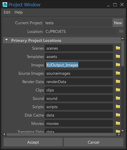

1 - In the "Project window" you can define an absolute path instead of the "images" folder:

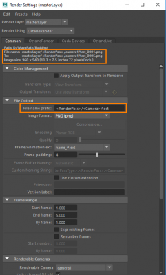

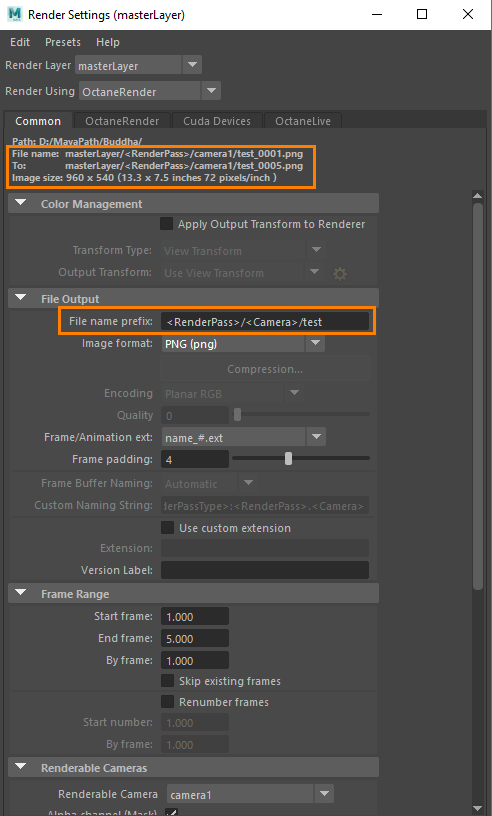

Please consider using the Project window to modify the render paths. Maya file name prefix parameters can be used to create subfolders and name of rendered images, for example: "<Camera>/<RenderLayer>/Draft_3_<Scene>_<RenderPass>"
