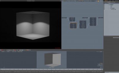

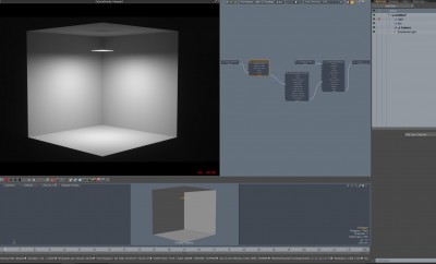

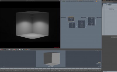

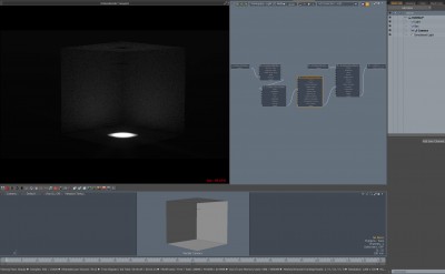

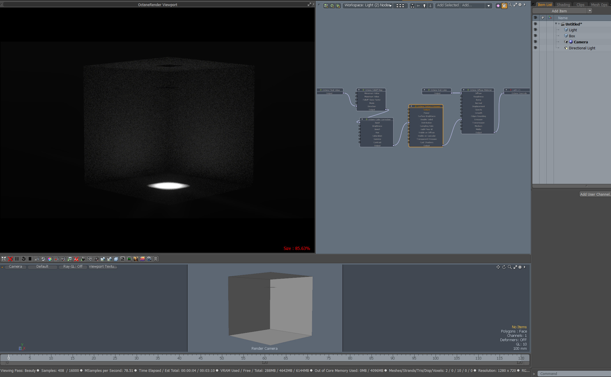

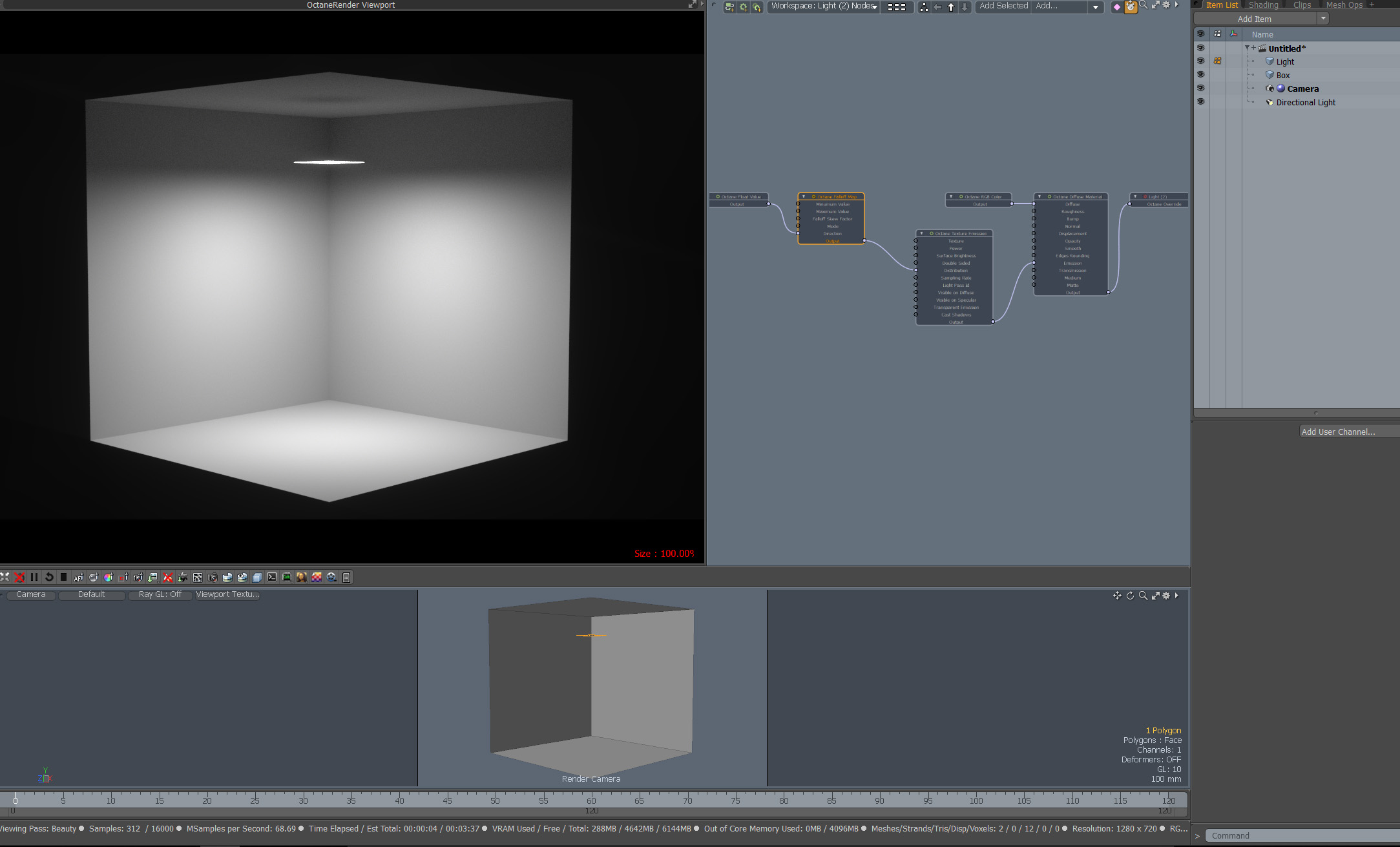

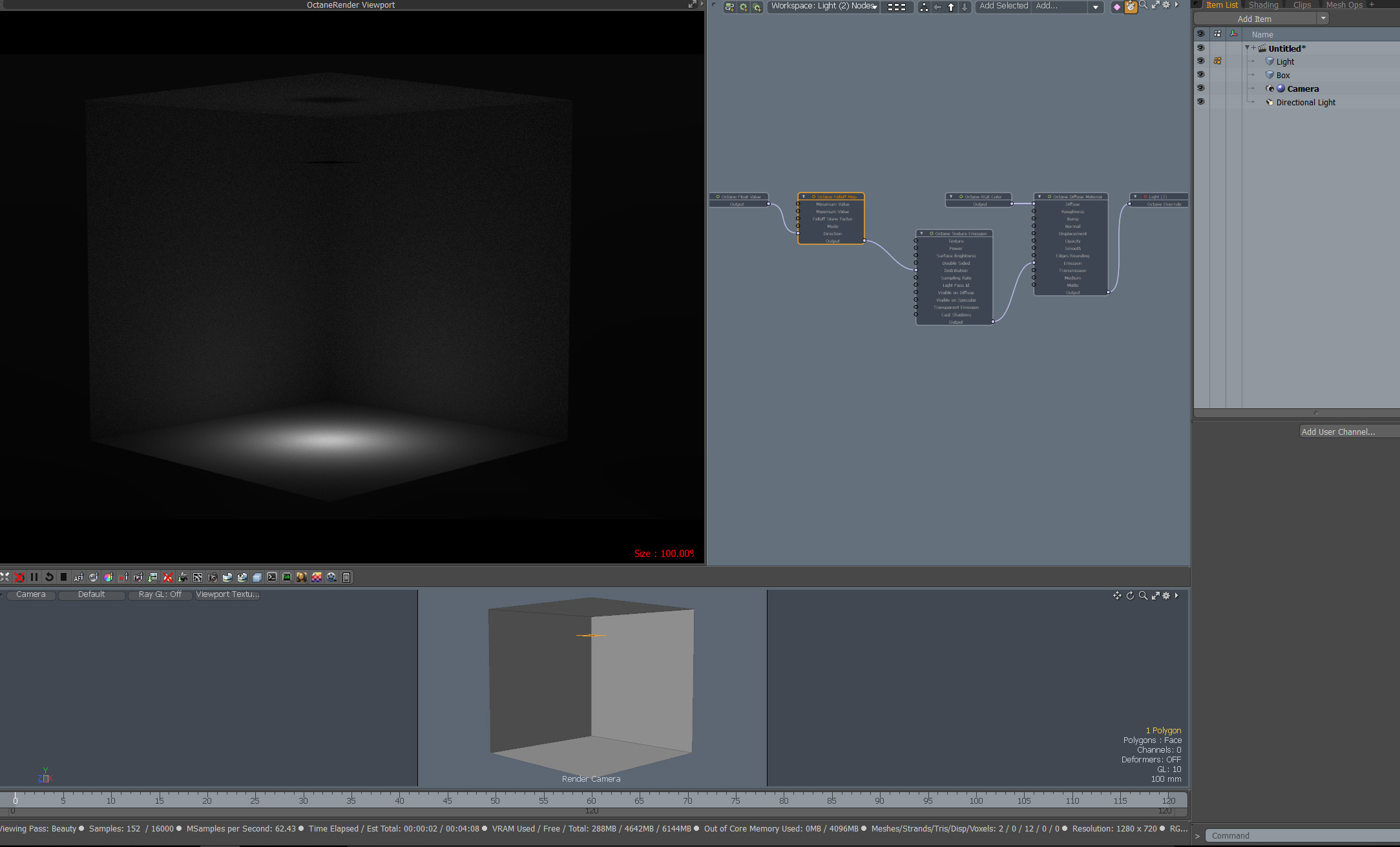

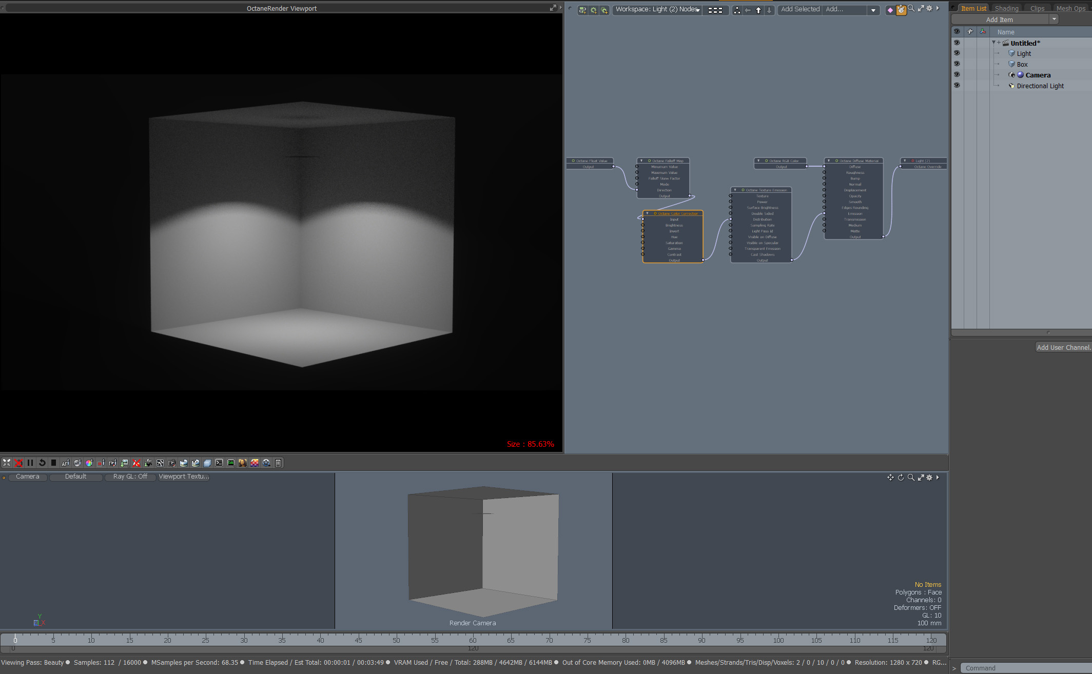

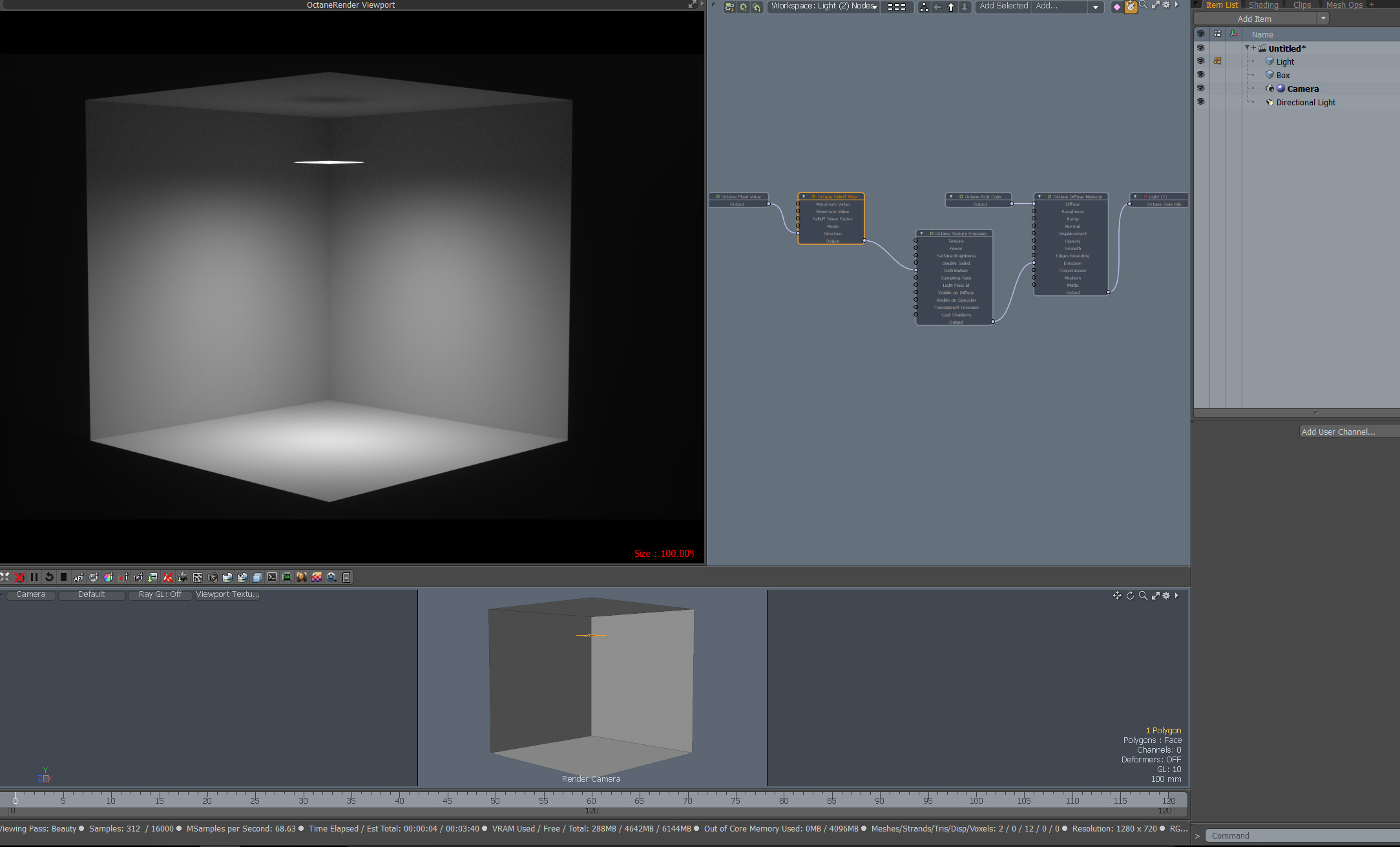

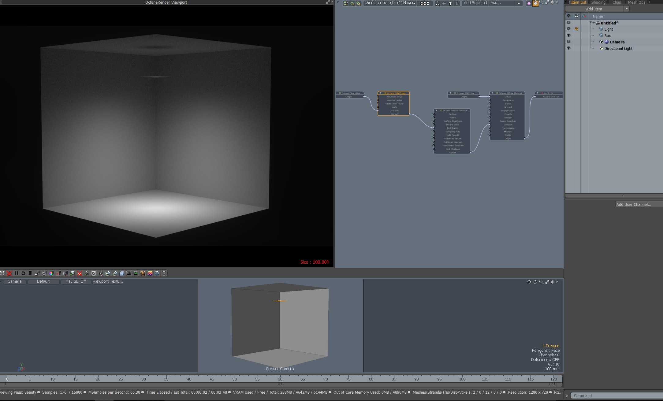

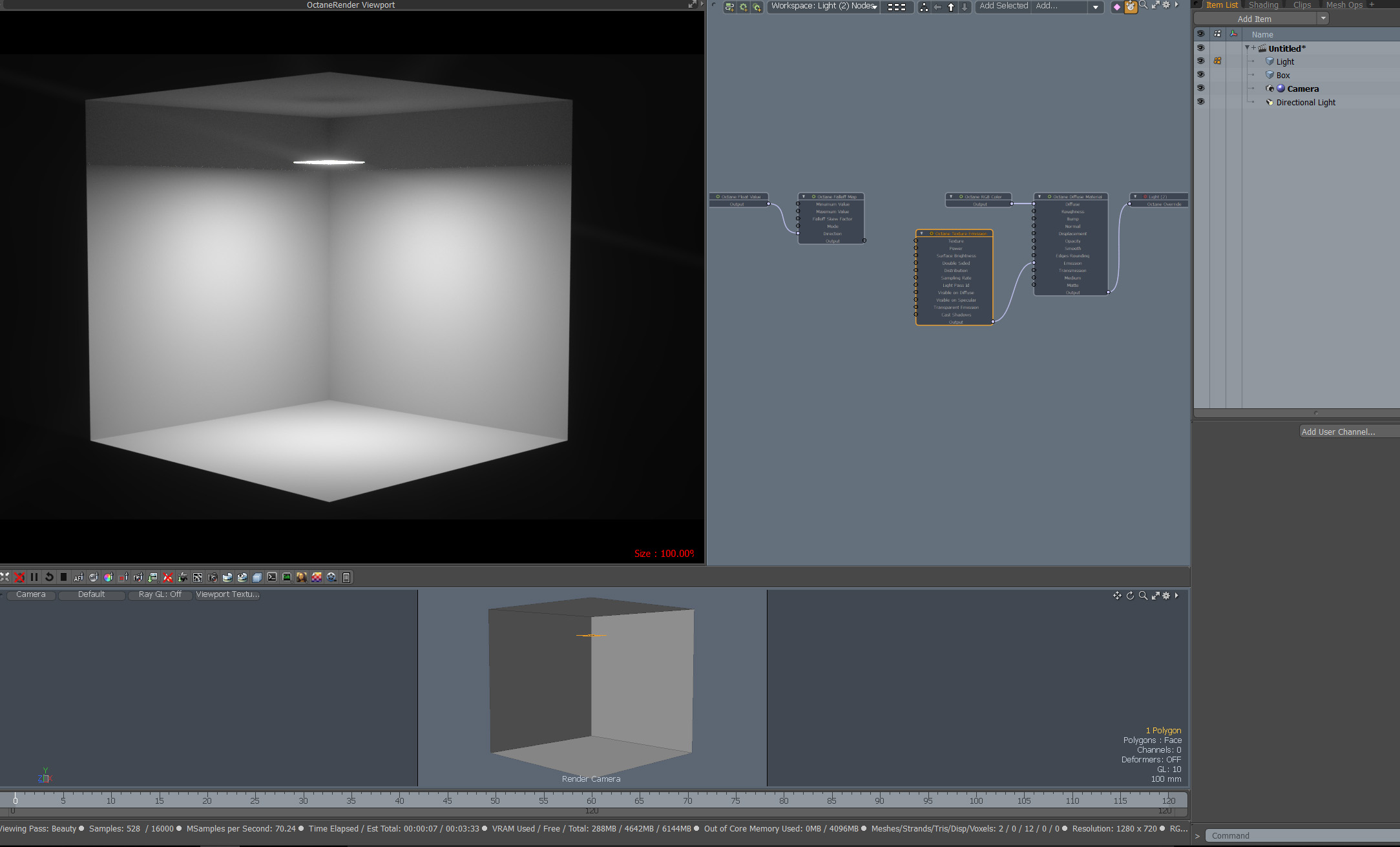

I tried it and i think it works:
Maybe there is a better way, but i think it looks way more natural than without it. As i said, its not as convenient as the fstorm Solution with a degree value. But it's something.
Again, if someone has a better idea or knows how to get a better result i would be happy to learn!

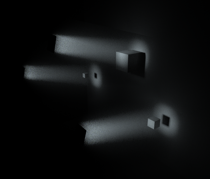

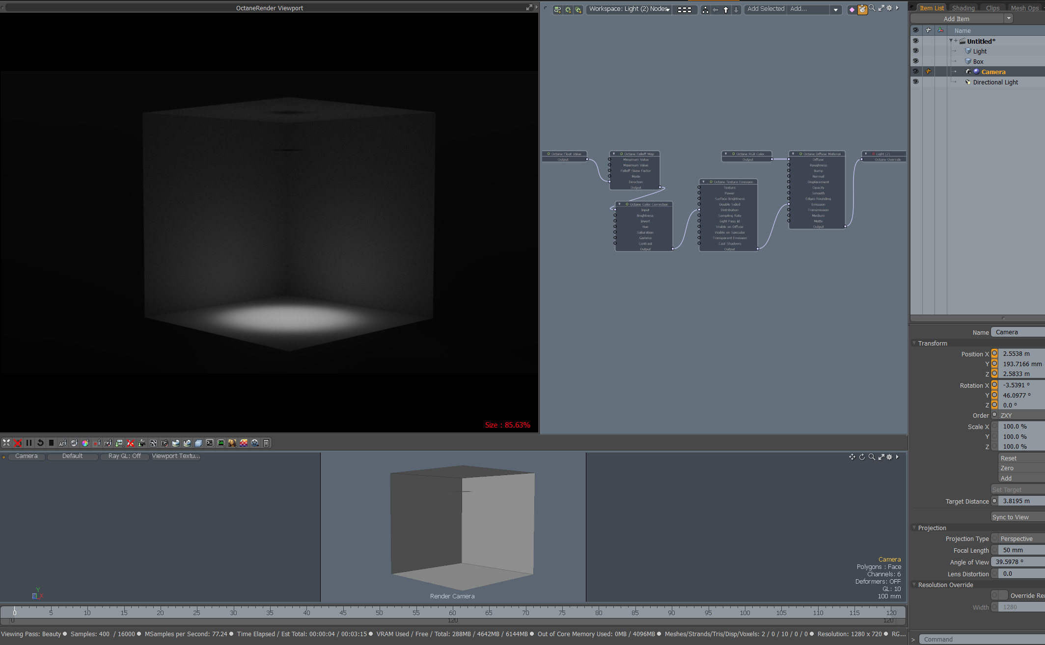

To enhance this further you can add a ColorCorrection and change the contrast to control the sharpness of the edges:

Looks very directional to me! again thanks for the tip.

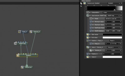

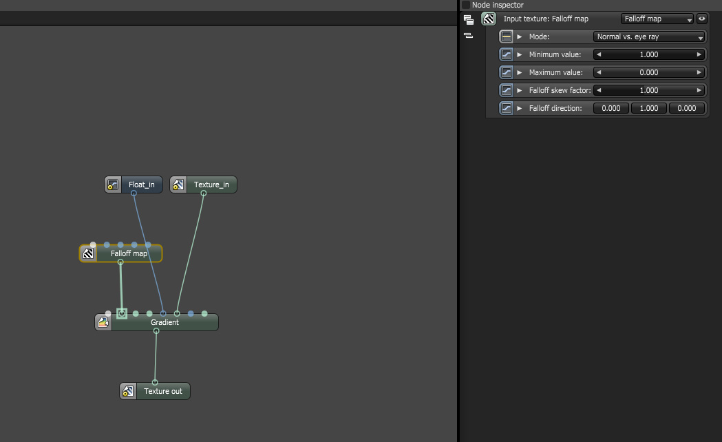

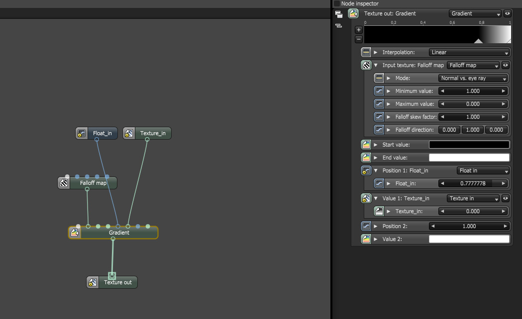

Hi Hesekiel2517,
thanks a lot for your solution.
I'm trying in rhino but I can't achieve those effects...please, can you show the values of the Falloff (mode, min, max, skew, direction)?
fabrizio
Hesekiel2517
Posts: 467
Joined: Mon Nov 23, 2015 10:57 pm
These are my settings. I found that there is much more control if you add a gradient. But you can also use the Falloff-Skew directly.
