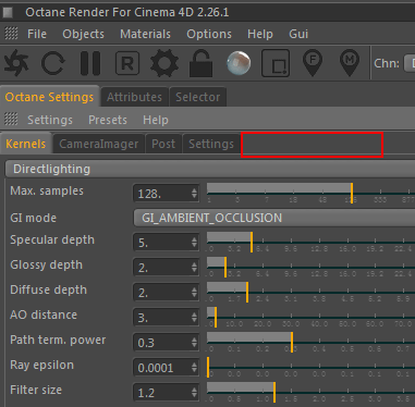

Lot Pass tag
moontooth
Posts: 44
Joined: Tue Feb 16, 2010 10:32 pm
Location: Vancouver
do not know why I lost my pass tag
C4D R15
OCT plugin 2.26.1
GTX 780ti
Win 7
Cuda 8
Driver: 376.51
please help me
Thanks!!

Hi moontooth,
because, from some time, has been removed, and you need to use the Render Settings / Render Passes tab instead.
It was inconvenient to have the same settings into two different places.
Now you can setup your passes for both LV and PV at the same time without confusion.
