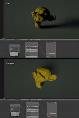

I'm having an with the latest version 12.00.
Scene with a hdri texture in the world tab saved in previous version is rotated differently. I have to reverse direction of a Translation value in Transform node to correct the rotation.

Hi J.C, I have been trying to reproduce the reported issues, but here it works fine. So I don't know what's going on yet.
Could you please describe the steps that you took to trigger this bug? And if you could send me the scene, that would be great. Thank you.

Looks like the version 11.20 had this bug. Before and in 11.24 and newer the rotation is the same.
I need to switch to 11.24.

Thanks J.C.
I can reproduce the problem, I'll look into it.

Hi J.C, thanks for your reports and help.
The problem is caused by the Octane 3.05.3 sdk changes. You can find the mirror transform between Octane Standalone 3.05.3 and previous versions too.
It will take some time for us to find a proper way to deal with this problem. (a simple reversion or fix would cause scenes made in newer sdks suffer from the same problem).
Currently, you have to reverse the transform in manual. Sorry about the inconvenience.
