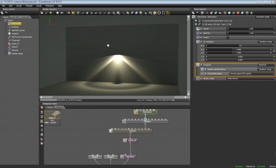

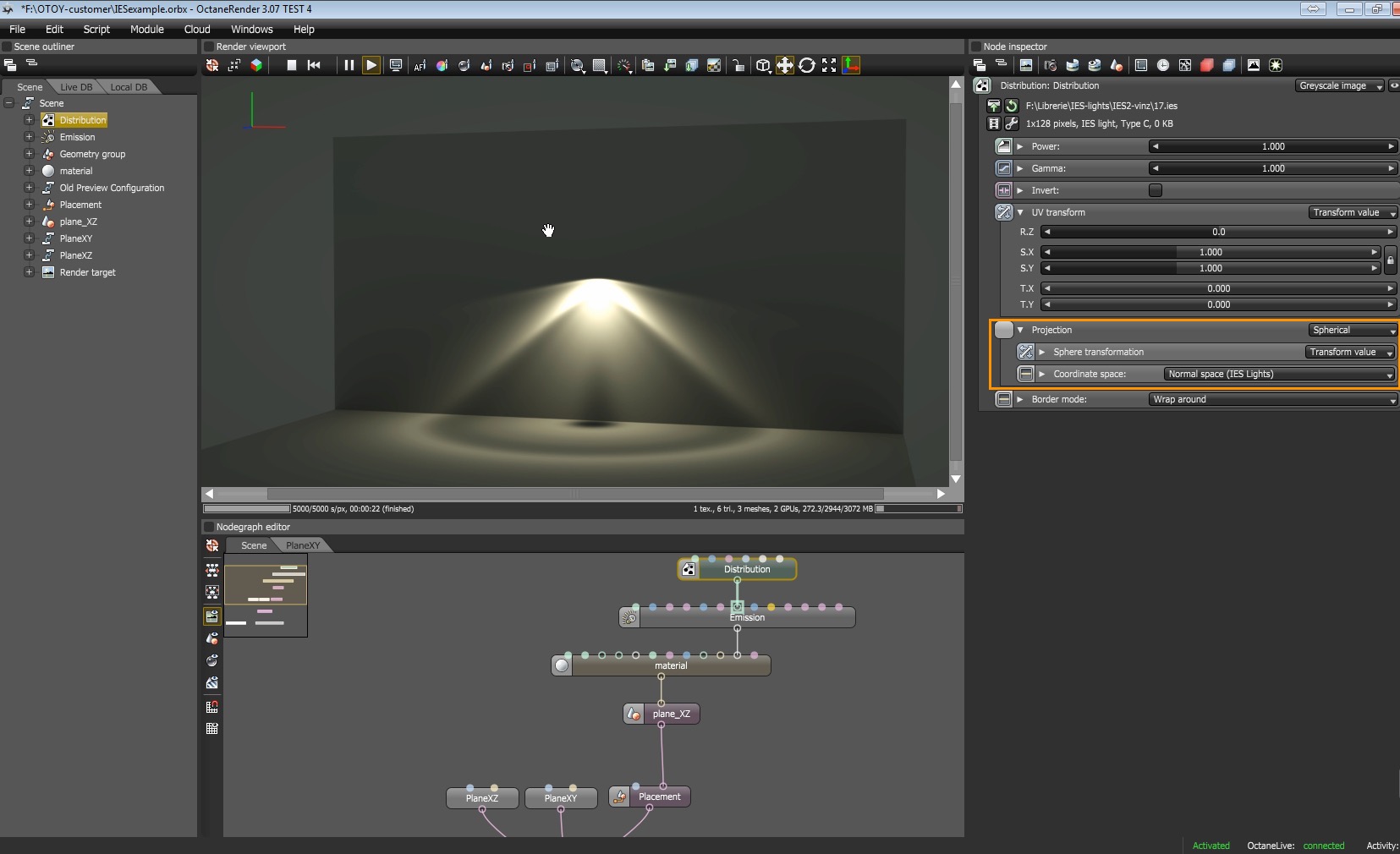

please, have a look at this example scene:
IESexample.orbx
(89.61 KiB) Downloaded 599 times
Basically, you need to use the IES file in the Distribution pin of the Emission node, and set the coordinate space to Normal space (IES Light).
