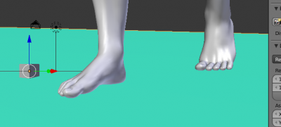

Hi. I'm fighting with this issue. It seems geometry doesnt import properly in Octane standalone. As you can see on this screenshot in Daz, the foot fit over the terrain.

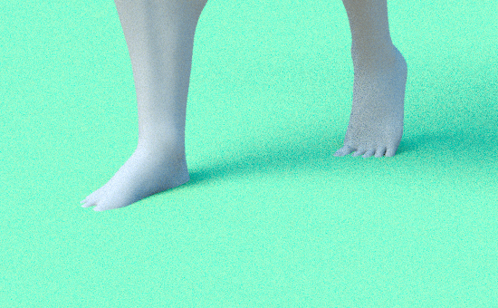

but when i import the OBJ geometry in Octane standalone, the terrain doesnt import properly.
It seems that Octane import subdividing the geometry, so is there someway for import without smoothing nor subdividing?

Try importing your terrain OBJ in Blender (free), if it's wrong there also then the terrain export is the problem...

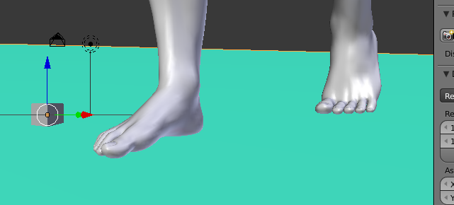

Phantom107 wrote:Try importing your terrain OBJ in Blender (free), if it's wrong there also then the terrain export is the problem...
in blender it's perfect

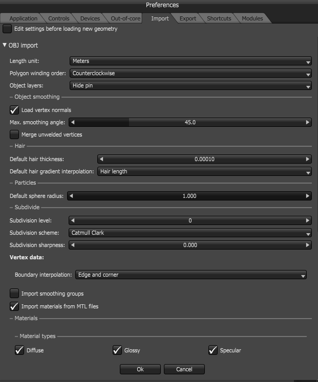

Haven't had this problem before. Within the OBJ properties in Octane, click the little wrench option. There are some subdivision options in there... put subdivision level to 0

Phantom107 wrote:Haven't had this problem before. Within the OBJ properties in Octane, click the little wrench option. There are some subdivision options in there... put subdivision level to 0
These are my settings on preferences. The subd level is 0 but I still have this issue.

Looking your blender screenshot, as blender standard cube is 1x1x1 meter, maybe its an unit problem…

In the 1st screenshot it looks like as if there's a kind of a ground plane above the terrain.
Maybe it's this ground plane mesh, we see the foot is poking in.

Erick wrote:In the 1st screenshot it looks like as if there's a kind of a ground plane above the terrain.
No, it's just the terrain. I think Octane standalone subdivide the geometry still when the subdivide option is 0.
