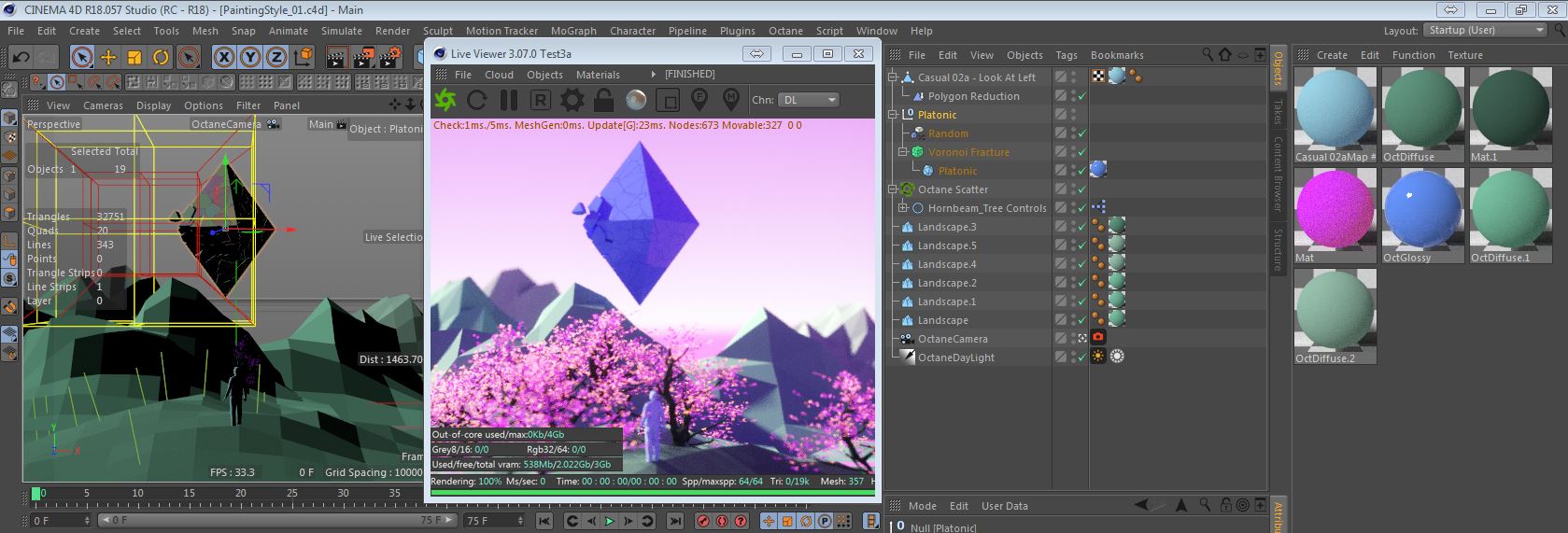

Hi RSgraphics,
interesting question, I have tried to roughly reproduce a scene similar to the image posted. maybe can give you some ideas:
PaintingStyle_01.7z
(7.66 MiB) Downloaded 334 times
ciao beppe
